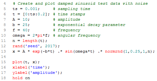

file contains code to create sampled data from a damped sinusoid response with
random noise.

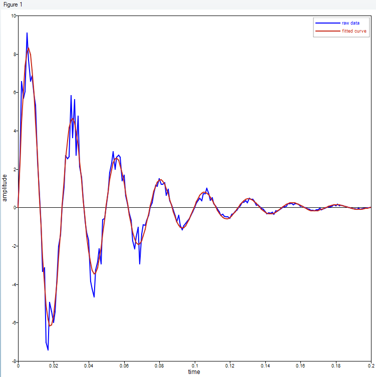

Plot the Fitted Curve with the Raw Data

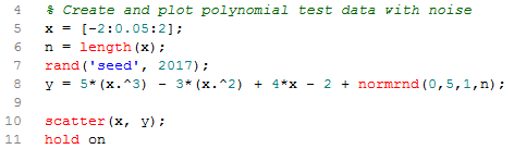

Create Test Data for Fitting with polyfit
- Start Compose.
- From the File menu, select Open and locate the file polyfitDemo.oml in the <installation_dir>/tutorials/ folder.
The file contains code to create data for a scatter plot with a polynomial
trend.

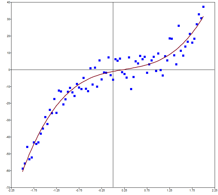

Using polyval with the coefficients (p) determined above, the fitted curve can be plotted together with the raw data.
