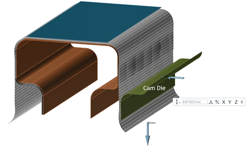

Figure 1. Crash Form Operation with a Cam Die
