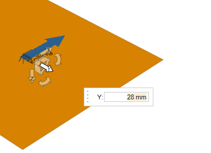

  3. Double-click on the blank to invoke the blank properties microdialog.
  4. In the microdialog that appears, define the Transfer between stages in the draw operation down to the millimeter using the button to invoke the Move tool, or reset the transfer using the button. The blank transfers are defined for all of the stages in the model file and saved there.
    There is no need to move the tools when you transfer the blank from one stage to the next.

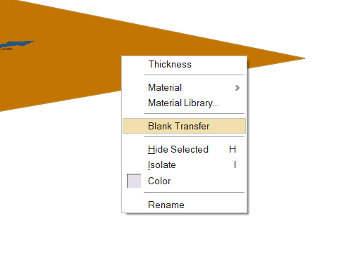

    Note: For a tailor-welded blank consisting of multiple parts, you must right-click on the blank to reveal the context menu and select Blank Transfer to define each transfer.
