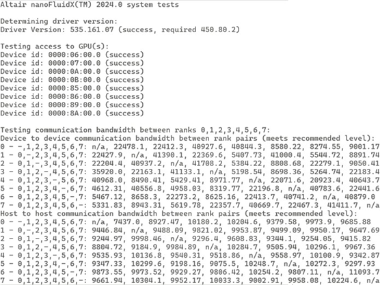

  3. Run system tests with the following:
    system_tests.py
  4. A successful test on a multi-GPU node will produce output similar to the following:

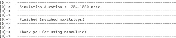

  7. Run the following:
    nanoFluidX:nfxmpirun_singlenode -np 1 $nFX_SP -i dambreak_3D_H300_dx0p005_wt.cfg -m 10
  8. The test run is successful when the message Finished (reached maximum steps) appears at the end.
