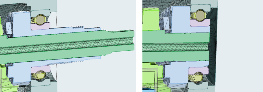

If you have a gear-train assembly with protruding shafts or axles, make sure you cut them up such that they are slightly offset inward from the wetted surface of the housing.

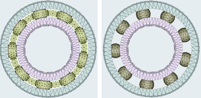

- Bearings are medium in size and have a considerable cage that holds the rolling elements
- Best practice: Remove the cage. The remaining space will typically allow
for some flow through the bearing.
Figure 2. . Full bearing geometry, including the cage on the left. Simplified bearing geometry with removed cage on the right. With moderate resolution, typically several particles can pass between the rolling elements.
