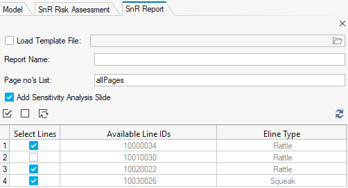

Sensitivity Analysis Selection in Automatic Report
When creating an automatic report, you can now select which E-lines should be included in the report for sensitivity analysis.
