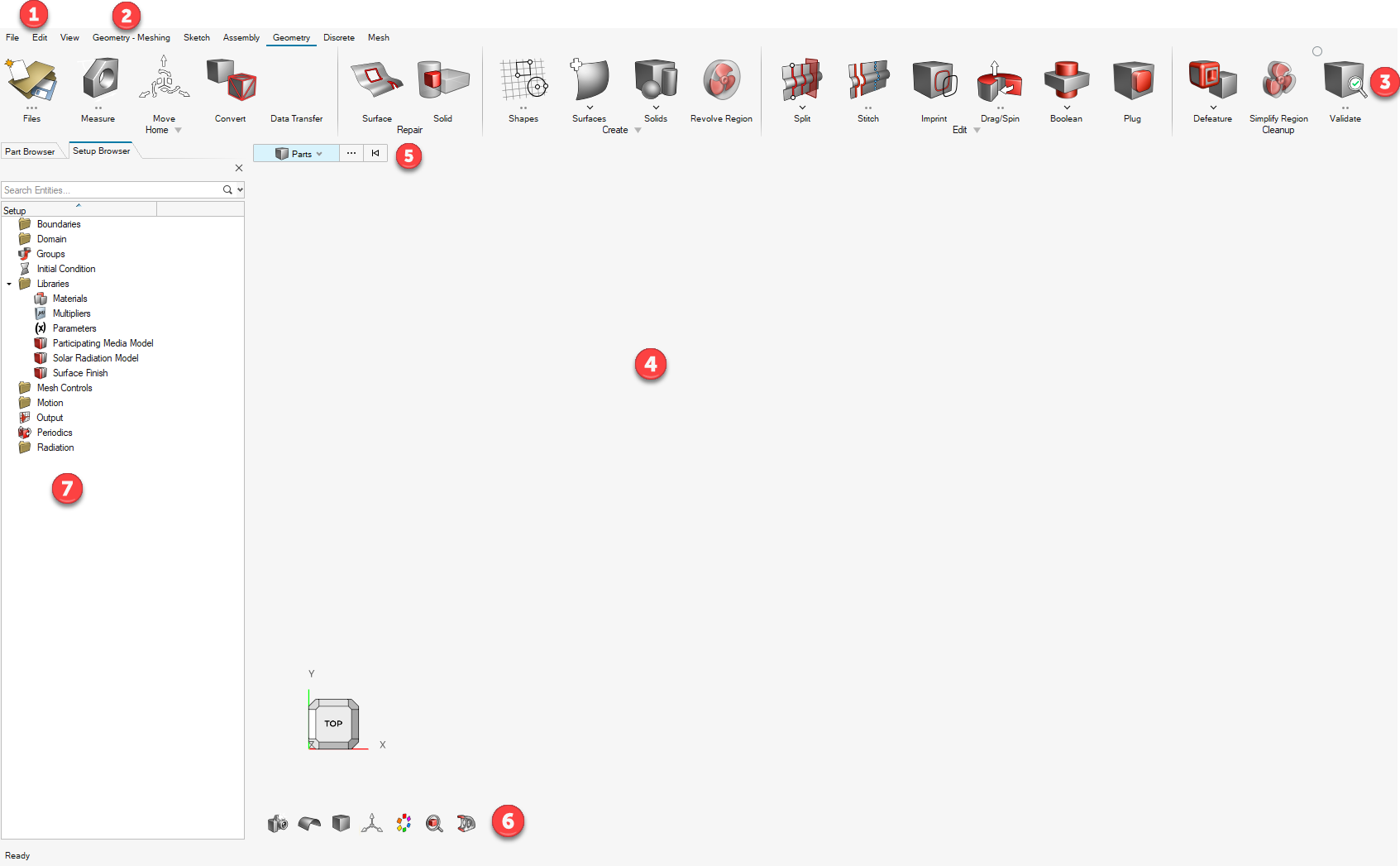

The HyperMesh CFD graphical user interface can be divided into seven general categories as shown in the figure above.
  1. The menu bar contains the drop-down menus for File input-output, Edit, and View operations.
  2. The modeling environment switcher is used to populate relevant ribbons and tools based on modeling tasks.
  3. Ribbons contain various functionalities and tools available in HM-CFD. Navigate between various ribbons by clicking the ribbon tabs to the right of the modeling environment switcher. After selecting a ribbon, the corresponding tool icons are displayed on the screen. The functionalities of various ribbons and corresponding tools are briefly explained in this section.

  4. The modeling window is where the model is displayed. The model display can be manipulated using the view controls shown in the table below. Clicking on the model will highlight the entity being selected and right-clicking on an entity will give you additional options for the operations that can be done based on the context. Some of the functions available using right-click are Show, Hide, Isolate, Select, Advanced select, Create groups, and so on.
    Button Operation
    Middle mouse scroll Zoom in and out
    Right-click hold and drag Pan the model
    Middle mouse click hold and drag Rotate the model
    Left-click Select entity
    Ctrl + Left-click Select multiple entities
    Left-click hold and drag Window select
    Shift + Left-click Deselect entities
  5. The entity selector enables you to control what entities can be selected using the left-mouse button. The selector can be set to any of the entities shown in the figure below. When you open any tool, the selector is automatically set to the entity (entities) which are appropriate for that command.
    Figure 17.
  6. The visualization of the model can be controlled using the tools available in View Controls toolbar. The display of mesh, model coloring, section cuts, standard views, and so on can be controlled using these tools.
    Figure 18.
  7. The browsers show the entities and setup parameters in the model and list them in a tree structure. They can be turned on or off from the View menu. Some common functions that can be performed in all browsers are show, hide, and isolate.
