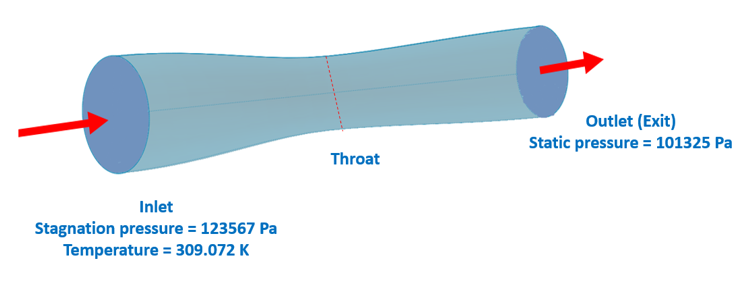

The problem to be addressed in this tutorial is shown schematically in Figure 1. It is based on the popular de Laval or converging-diverging nozzle. It consists of a tube that is pinched in the middle making an axisymmetric hourglass shape. Air at high pressure enters the inlets and the flow accelerates as the area of the nozzle decreases. The flow reaches sonic speed at the throat and becomes choked. A region of supersonic flow forms just downstream of the throat. Unlike a subsonic flow, the supersonic flow accelerates as the area gets bigger. This region of supersonic acceleration is terminated by a normal shock wave. The shock wave produces a near-instantaneous deceleration of the flow to subsonic speed. This subsonic flow then decelerates through the remainder of the diverging section and exhausts as a subsonic jet.
The exit to throat area ratio of the nozzle is 1.5. The radius at the inlet is 0.892 m, while the radius at the outlet is 0.691 m. The inlet stagnation pressure and the inlet temperature are 123,567 Pa and 309.072 K, respectively. The static pressure at the outlet is set to 101,325 Pa. The fluid in this problem is air, where the flow is assumed inviscid (viscosity and conductivity are zero) and density is based on the ideal gas model.

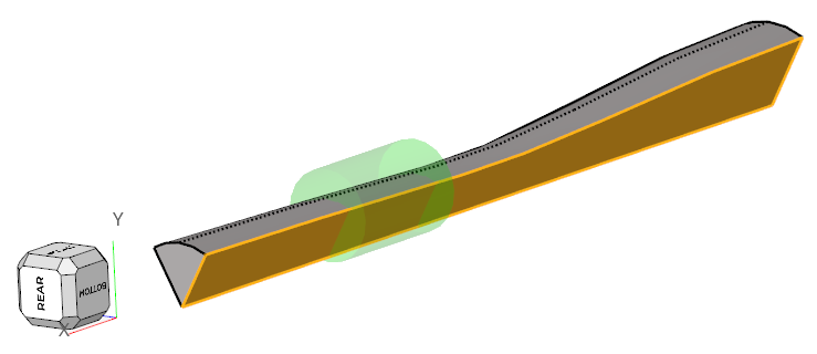

The problem is rotationally periodic about the longitudinal axis, and it is assumed that the resulting flow is also rotationally periodic, allowing for modeling with the use of a wedge-shaped section. For this tutorial, a 60° section of the geometry is modeled, as shown in the figure. Modeling a portion of a rotationally periodic geometry leads to reduced computation time while still providing an accurate solution.
The AcuSolve simulation will be set up to model a transient supersonic flow where the flow variables reach an asymptotic state to determine the stable flow solution.

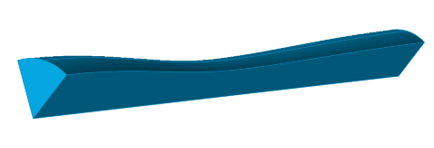

To focus on the physics part of the simulation, this tutorial input file contains geometry which has already been validated. Observe that a blue check mark appears on the top-left corner of the Validate icon on the Geometry ribbon. This indicates that the geometry is valid, and you can go to the flow set up.

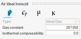

  2. Under Settings, click Ideal Gas, and then click the My Material tab.
  3. Click to add a new ideal gas model.

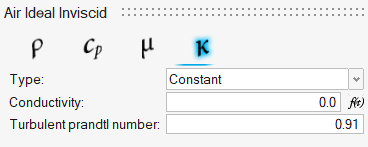

  4. Keep the default values for the Gas constant and the Specific heat and set the Viscosity and Conductivity values to 0.
  5. Rename the model to Air Ideal Inviscid.

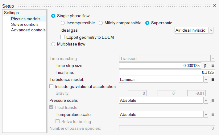

  2. Under the Physics models setting:
    1. Select the Supersonic radio button under Single phase flow.
    2. Set the Ideal gas model to Air Ideal Inviscid.
    3. Set the Time step size to 0.000125.
    4. Set the Final time to 0.3125.
    5. Verify that the Turbulence model is set to Laminar.
    Figure 8.

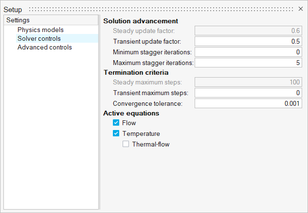

  3. Click the Solver controls setting.
  4. Set the Transient update factor to 0.5.
    Note: Since we are interested in a solution that reaches a steady state, the transient update factor can be set to a non-zero value without affecting the solution accuracy.
  5. Set the Maximum stagger iterations to 5.
    Figure 9.

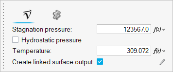

  3. In the microdialog, enter the following values for the stagnation pressure and temperature.
    Figure 13.
  4. On the guide bar, click to execute the command and exit the tool.

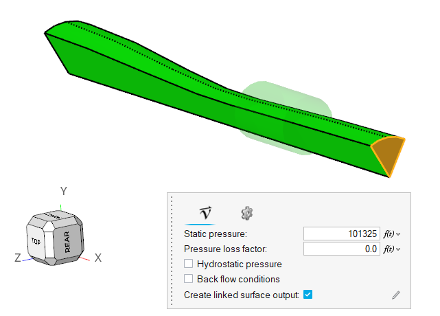

  5. Click the Outlet tool.
    Figure 14.
  6. Select the face highlighted in the figure below, enter the 101325 as the static pressure value, and then click on the guide bar.
    Figure 15.

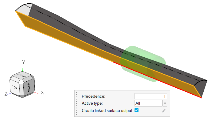

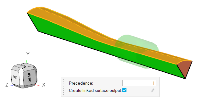

  9. Click the Periodic > Rotation tool.
    Figure 18.
  10. Select the face highlighted below as the Source.
    Figure 19.
  11. Click Target on the guide bar and then select the opposite face.
    Figure 20.
  12. Click on the guide bar.

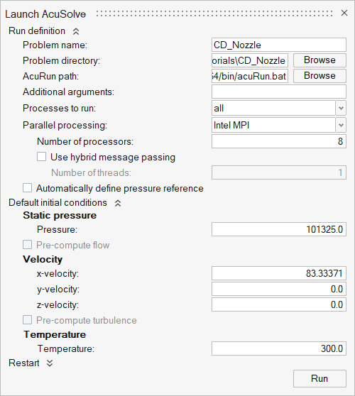

Run AcuSolve
  1. From the Solution ribbon, click the Run tool.
    Figure 23.
  2. Set the Parallel processing option to Intel MPI.
  3. Optional: Set the number of processors to 4 or 8 based on availability.
  4. Expand Default initial conditions and enter the values as shown below.
  5. Leave the remaining options as default and click Run to launch AcuSolve.
    Figure 24.
    The Run Status dialog opens. Once the run is complete, the status is updated and you can close the dialog.

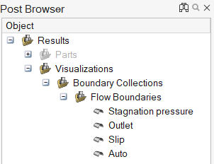

    The solid and all the surfaces are loaded in the Post Browser.

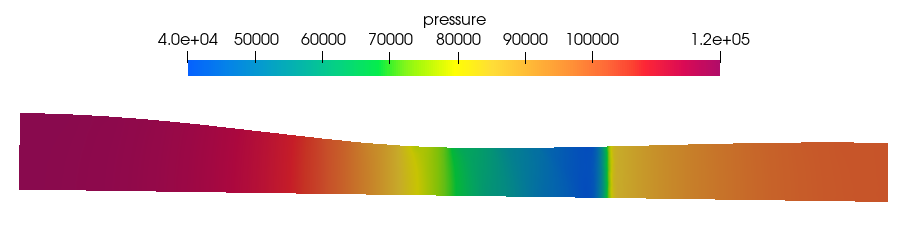

  5. Click the Slice Planes tool.
    Figure 27.
  6. Select the x-y plane in the modeling window.
  7. In the slice plane microdialog, click to create the slice plane.

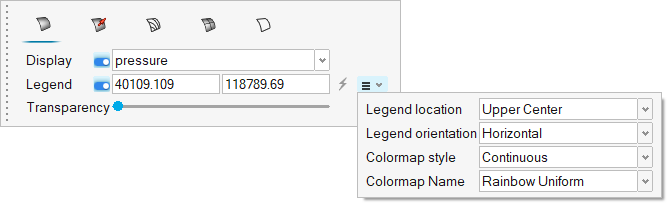

  8. In the display properties microdialog, set the display to pressure and activate the Legend toggle.
  9. Click and set the Legend location to Upper Center, the Legend Orientation to Horizontal, and the Colormap name to Rainbow Uniform.
    Figure 28.
  10. Click on the guide bar.
  11. In the Post Browser, hide the Flow Boundaries surfaces to display the pressure contours on the slice plane.
    Figure 29.

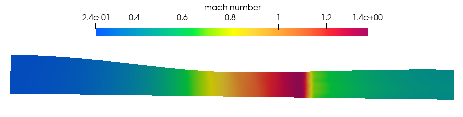

    Similarly, you can display the Mach number contour.
    Figure 30.
