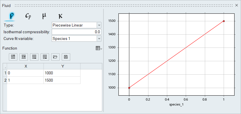

  4. For density:
    1. Change the type to Piecewise Linear.
    2. Define the Curve fit variable as Species 1.
    3. Click twice under Function then enter 1000 kg/m3 and 1500 kg/m3 in the Y column for the density of water and honey, respectively.
    Figure 9.
