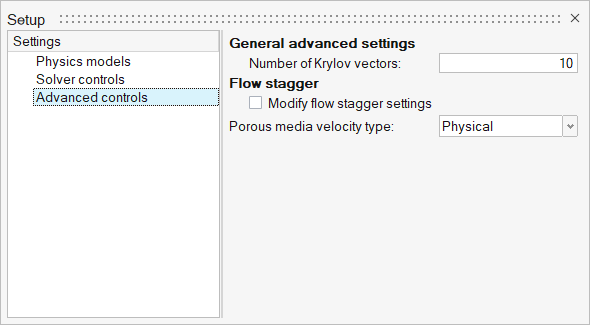

  5. Click the Advanced controls setting.
  6. Confirm that the Porous media velocity type is set to Physical.
    Figure 7.

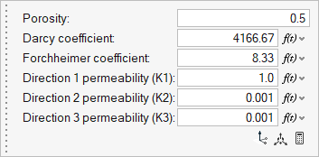

  3. On the guide bar, click Orientation.
  4. Left-click to place a point anywhere on the selected solid.
  5. In the microdialog, enter the following values for the coefficients.
    Figure 12.
  6. In the microdialog, click to open the Orient tool then verify that the direction is aligned to the global x-axis.

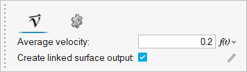

  3. In the microdialog, set the average velocity to 0.2.

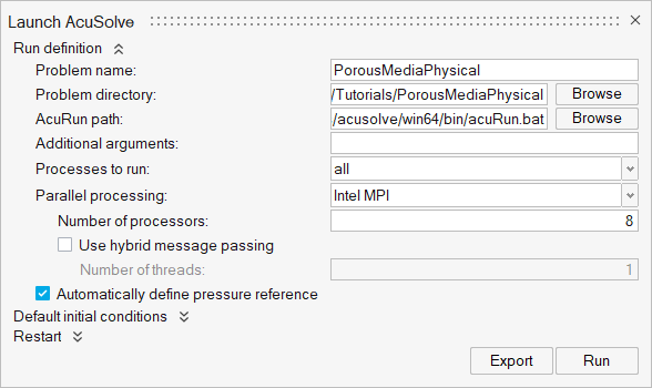

  1. From the Solution ribbon, click the Run tool.
    Figure 21.
  2. Set the Parallel processing option to Intel MPI.
  3. Optional: Set the number of processors to 4 or 8 based on availability.
  4. Leave the remaining options as default and click Run to launch AcuSolve.
    Figure 22.

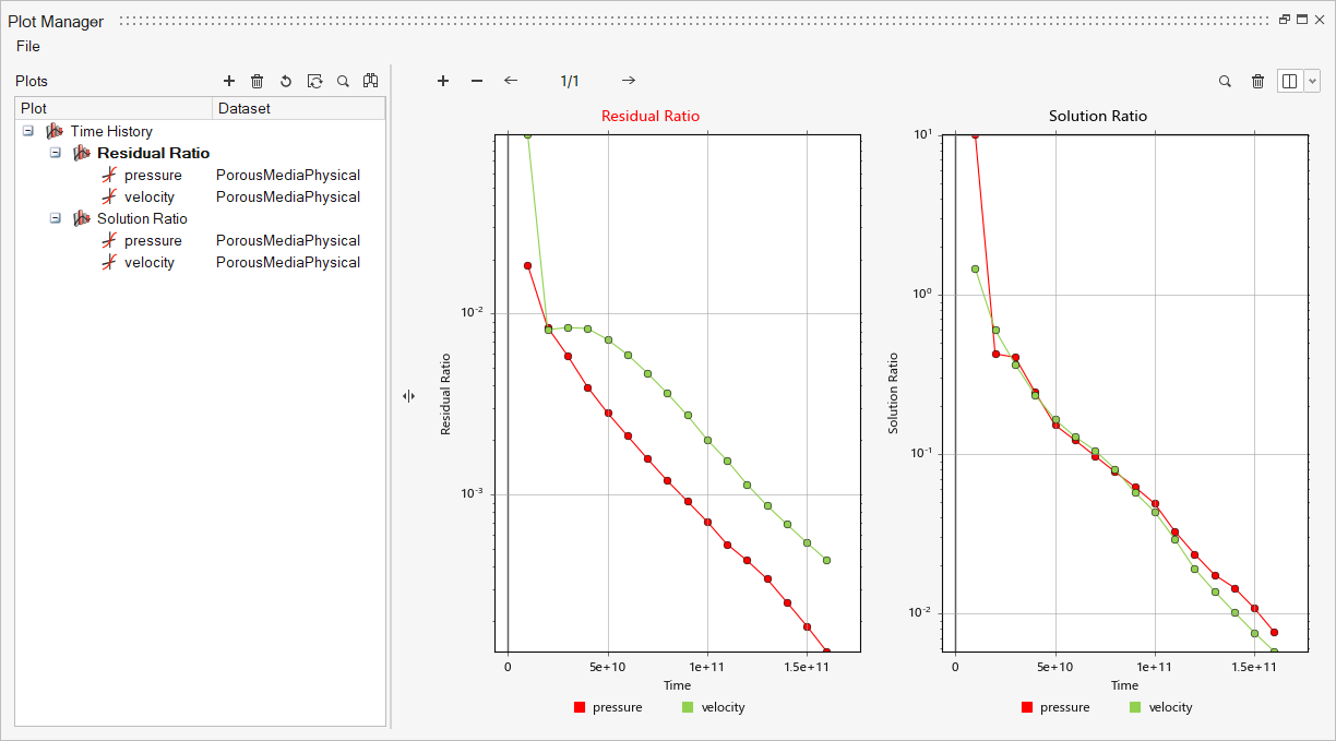

  1. In the Run Status dialog, right-click AcuSolve run and select Plot time history to launch the Plot Manager.
    Figure 23.

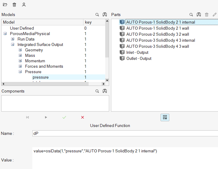

  3. Right-click User Defined under the Model panel to create a user-defined function.
  4. In the Data Tree, expand Integrated Surface Output > Pressure and then select pressure.
  5. In the Name field, enter dP.
  6. In the Value field, type value=.
  7. Under Parts, choose AUTO Porous-1 SolidBody_2_1 internal and then click to insert the field as part of the value, as shown below.
    Figure 24.

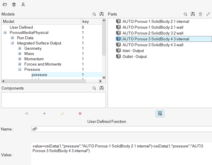

  8. Type - at the end of the user-defined function value.
  9. Under Parts, choose AUTO Porous-3 SolidBody_4_3 internal and then click to insert the field as part of the value.
  10. Click to add the user-defined function.
    Figure 25.

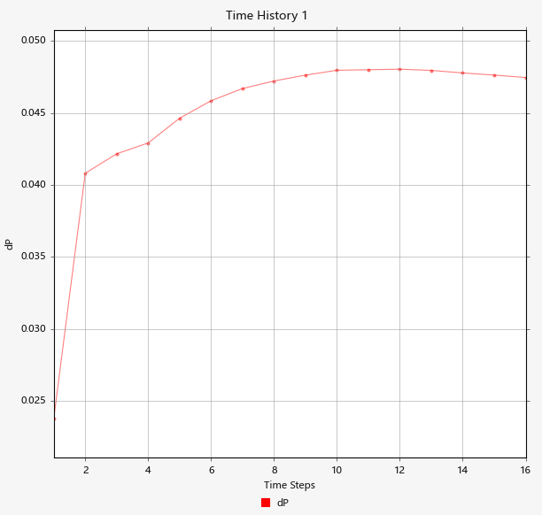

  11. Click the x axis to switch to Time Steps.
    Figure 26.
    The pressure drop across the porous inlet (AUTO Porous-1 SolidBody_2_1 internal) and porous outlet (AUTO Porous-3 SolidBody_4_3 internal) surfaces is 0.047 Pa.
