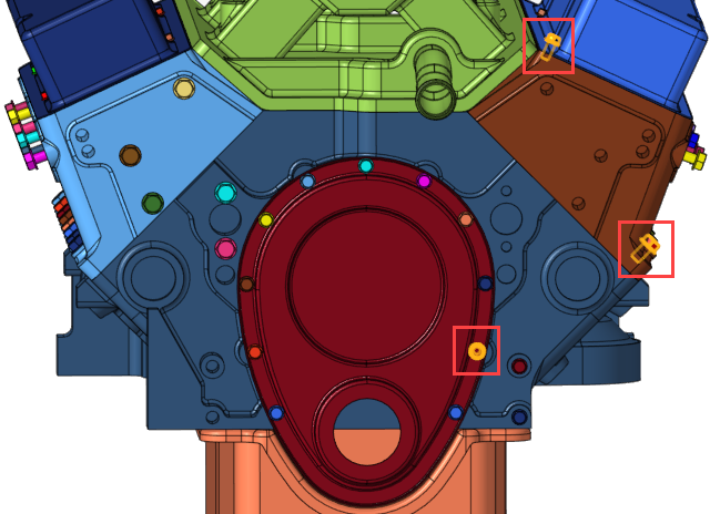

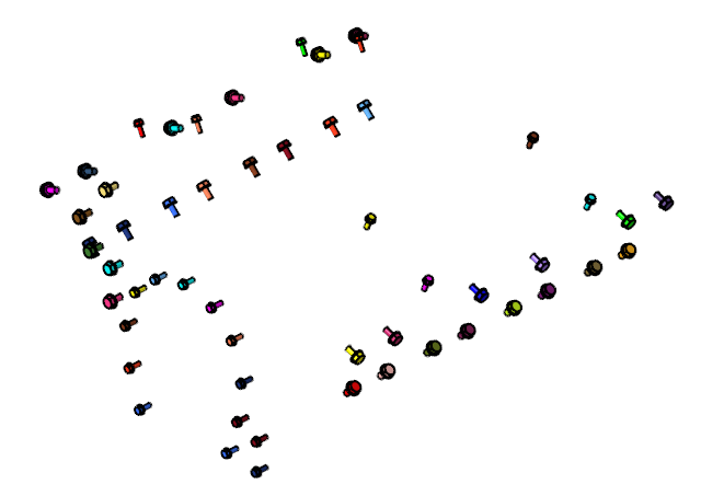

  3. Select the three bolts parts highlighted in the figure below.
  4. Right-click and select Find and Isolate > Matching Parts.
    The tool searches for all bolts matching the features of the highlighted parts and isolates them on the screen.
  5. Left-click and drag to select all the bolts on the screen then right-click and select Create Group.
  6. Label the group Misc then click Create.

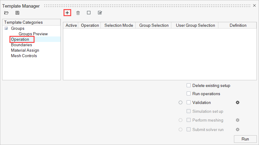

  1. Click the arrow next to the Home tool set, then select Template Manager.
    Figure 4.
  2. Select Operation from the list of categories in the Template Manager dialog.
  3. Click to add an operation.

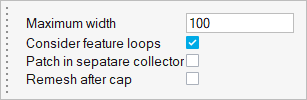

    Figure 7.
  10. Click and enter a maximum width of 100.
    Figure 8.

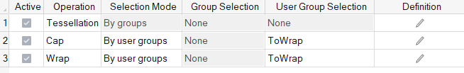

  11. Click to add another operation.
  12. Double-click in the Operation column and select Wrap.
  13. Under the Selection Mode column, select By user groups.
  14. Under the User Group Selection column, select ToWrap.
    Figure 9.

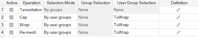

  16. Click to add another operation.
  17. Double-click in the Operation column and select Re-mesh.
  18. Under the Selection Mode column, select By user groups.
  19. Under the User Group Selection column, select ToWrap.
    Figure 11.

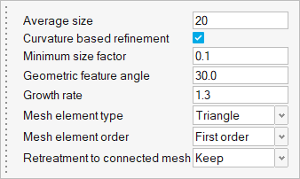

  20. Click and enter a value of 20 for the Average size.
    Figure 12.

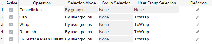

  21. Click to add another operation.
  22. Double-click in the Operation column and select Fix Surface Mesh Quality.
  23. Under the Selection Mode column, select By user groups.
  24. Under the User Group Selection column, select ToWrap.
    Figure 13.

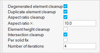

  25. Click and enable Degenerated element cleanup, Duplicate element cleanup, Aspect ratio cleanup, and Intersection cleanup.
    Figure 14.

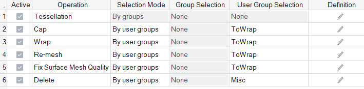

  26. Click to add another operation.
  27. Double-click in the Operation column and select Delete.
  28. Under the Selection Mode column, select By user groups.
  29. Under the User Group Selection column, select Misc.
    Figure 15.

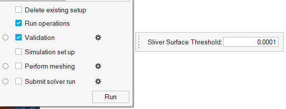

  30. At the bottom of the dialog, enable Run operations and Validation.
  31. Click next to Validation and set the Sliver Surface Threshold to 0.0001.
    Figure 16.
  32. Click Run to execute the template.
