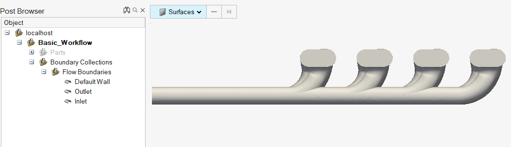

Load the Results in Post
  1. Navigate to the Post ribbon.
  2. From the menu bar, select File > Open > Results.
  3. Navigate to your working directory, select the Exhaust_Manifold.1.Log file, and click Open.
    The solid and all the surfaces are loaded in the Post Browser.

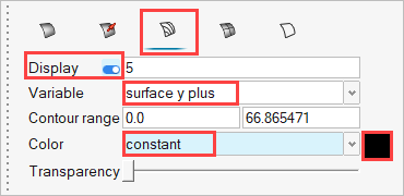

  4. Click the Contours Line Display tab.
  5. Turn on the Display.
  6. Set the Variable to surface y-plus.
  7. Set the Color to Constant.
  8. Change the color to Black.
    Figure 5.

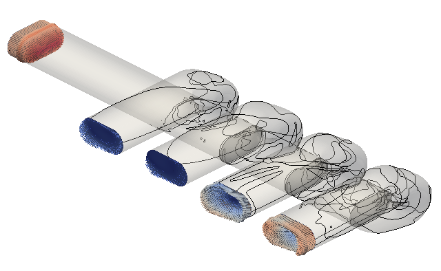

Set Velocity Contours and Vectors on the Inlets and Outlets
  1. Right-click on the Inlet surface in the Post Browser and select Edit from the context menu.
  2. In the microdialog, set the Display to velocity.
  3. Click to refresh the legend.

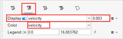

  4. Click the Vector Display tab.
  5. Turn on the Display and set the vector scale factor to 0.003.
  6. Set the Color to velocity.
    Figure 6.
  7. On the guide bar, click to execute the command and exit the tool.
  8. Repeat steps 1-7 for the Outlet surface.
    Figure 7.

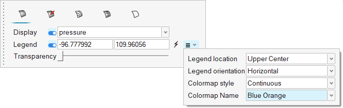

Set Pressure Contours on the Internal Surfaces
  1. Right-click on the Default Wall surface in the Post Browser and select Edit from the context menu.
  2. In the microdialog, set the Display to pressure.
  3. Turn on the Legend.
  4. Click next to Legend.
  5. Set the Legend location to Upper Center.
  6. Set the Legend orientation to Horizontal.
  7. Set the Colormap name to Blue Orange.
    Figure 8.
  8. On the guide bar, click to execute the command and exit the tool.

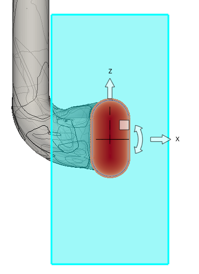

  2. From the secondary ribbon, select the Rectangle tool.
    Figure 10.
  3. Select the plane perpendicular to the X-axis as the reference plane for the rectangle.
  4. Select the Top face on the View Cube to orient the model.
    Figure 11.

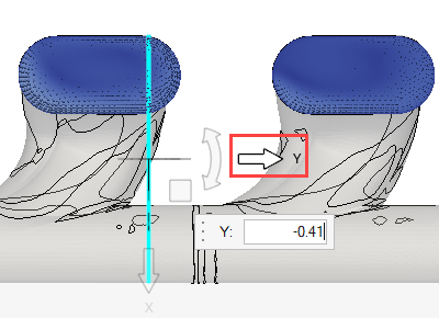

  5. Click in the microdialog to active the Move tool.
  6. Click on the white arrow along the local Y-direction.
  7. Enter a value of -0.41 and press Enter.
    Figure 12.

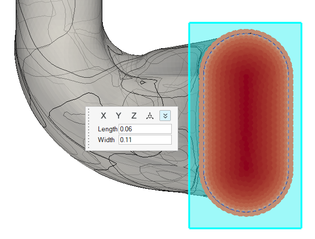

  14. Click in the microdialog and set the length and width to 0.06 and 0.11, respectively.
    Figure 15.

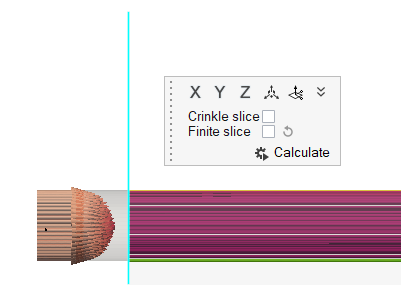

  15. Click Seeds on the guide bar.
  16. Set the Generation method to random and the Point count to 100.
  17. Click Calculate.

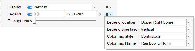

  18. In the microdialog, set the Display to velocity.
  19. Turn on the Legend.
  20. Click next to Legend.
  21. Set the Legend location to Upper Right Corner.
  22. Set the Colormap name to Rainbow Uniform.
    Figure 16.
