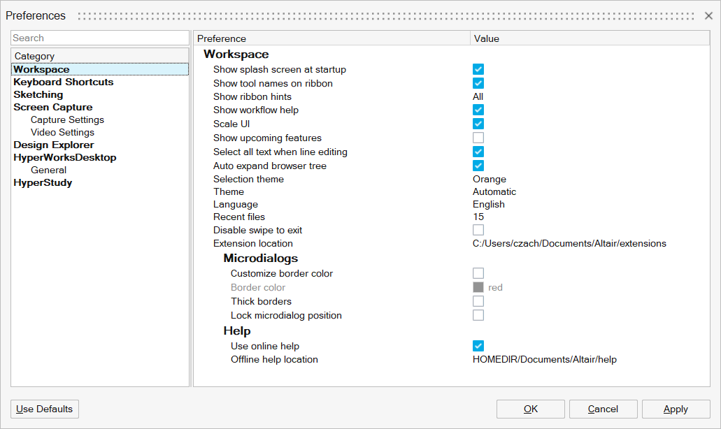

  2. Go to File > Preferences to access additional HyperStudy display options.
    See the tool tips in the dialog for information on the various options.
