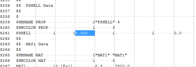

In the same line as PSHELL, highlight the value 0.002 for the PSHELL thickness
as indicated in Figure 1.
Note: In an OptiStruct deck, each field within a card is 8 characters long. Properly select the value for the PSHELL thickness by selecting 0.002 and the three spaces that follow.

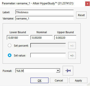

- Right-click on the highlighted fields and select Create Parameter from the context menu.
In the Parameter: varname_1 dialog, define the Thickness
parameter.
- In the Label field, enter Thickness.
- Change the Upper bound to 0.0022, the Nominal to 0.0020, and the Lower bound to 0.0018.
- Change Format to %8.5f.
- Click OK.

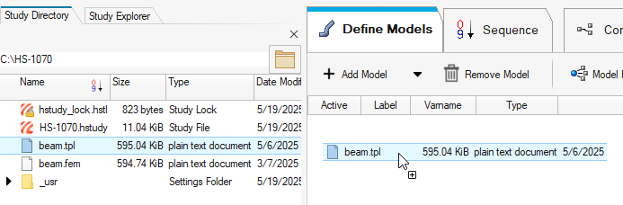

- Go to the Define Models step.
Add a Parameterized File model.
Figure 4.
Click Import Variables.
Two input variables are imported from the beam.tpl resource file.

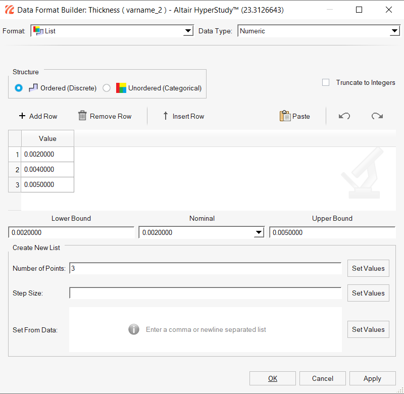

- Go to the Define Input Variables step.
In the Format column for the input variable Thickness, click
The Data Format Builder window opens. - From the Format drop-down, select List.
- Set the Structure to Ordered (Discrete).
Define the number of points for Thickness.
- Add three Value rows by clicking Add Row three times.
- Change the values in the new rows to the following: 0.002, 0.004, and 0.005.
- In the Number of Points field, enter 3.
- Click OK.
Figure 5.

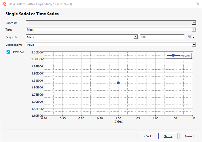

- Go to the Define Output Responses step.
- From the Directory, drag-and-drop the beam.out file, located in approaches/setup_1-def/run__00001/m_1, into the work area.
- In the File Assistant dialog, set the Reading technology to Altair® HyperWorks® and click Next.
- Select Single Item in a Time Series, then click Next.
Define the following options, then click Next.
- Set Type to Mass.
- Set Request to Mass.
- Set Component to Value.
Figure 6.

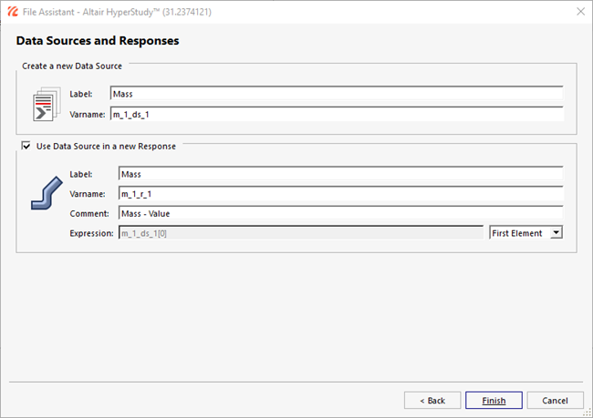

- Label the output response Mass.
Set Expression to First Element.
Note: Because there is only a single value in this data source, [0] is inserted after m_1_ds_1, thereby choosing the first (and only) entry in the data source.
Click Finish.
Figure 7.
