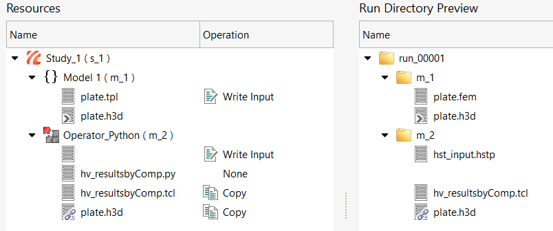

Define a model dependency that references the python script that will be used
as the solver script.
This is a reference to a file that is not generated during a solver run, therefore it is of type Normal. This file does not need to be in the run directory.
Set the Solver execution script.
Option Description Python based model - Set the Solver Execution Script to Python (py).
- In the Solver Input Arguments column, enter
${m_2.file_2} ${m_2.file_4}.
The input arguments are references to the model resources' varnames. The first argument (m_2.file_2) is a reference to the model resource’s varname, and tells python which script to run. The second argument (m_2.file_4) is the varname to the target result file to split, and will be the first argument to the python script.
Figure 4.
Direct Solver (hw.exe) Model - Set the Solver Execution Script to HyperWorks (hw.exe).
-tcl ${m_2.file_2} -b -result ${m_2.file_3}.
The input arguments are references to the model resources' varnames. The first argument (m_2.file_2) is a reference to the model resource’s varname, and tells hw.exe which tcl script to run. The second argument (m_2.file_3) is the varname to the target result file to split.
Figure 5.

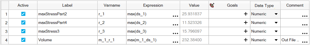

Create and Evaluate Output Responses
In this step you will create four output responses: maxStressPart2, maxStressPart4, maxStress3, Volume.
- Go to the Define Output Responses step.

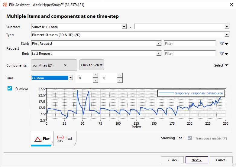

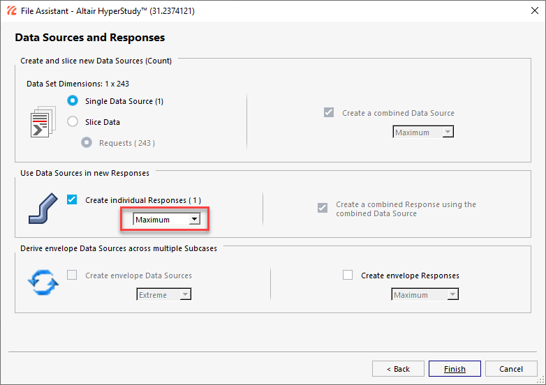

Create the maxStressPart2 output response.
Create the maxStressPart4 output response.
Create the maxStress3 output response.
Create the Volume output response.
The Volume output response is added to the work area.
- Click Evaluate to extract the response values.

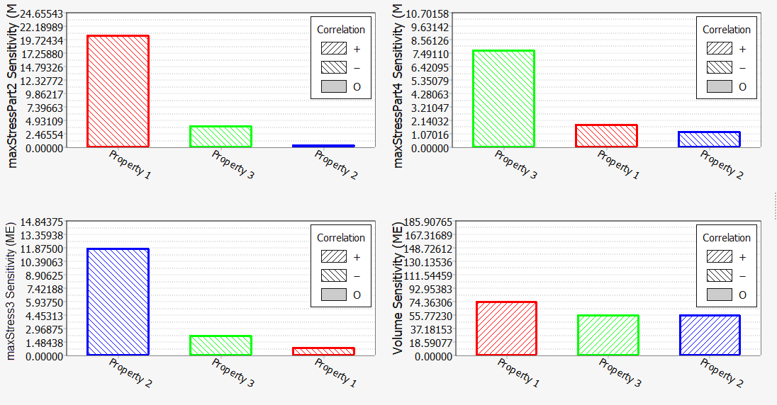

Click the Pareto Plot tab to plot the effects of
variables on output responses in hierarchical order (highest to lowest).
Each variable contributes nearly equally to volume. A positive hashing indicates that the relationship is positive: as the variable increases, mass increases. For the three stress output responses, the maximum stress in each zone is dominated by the thickness of that zone.
