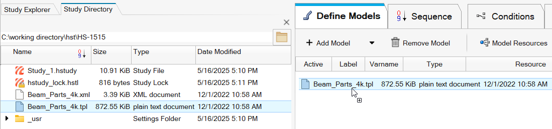

  5. Add a Parameterized File model.
    1. From the Directory, drag-and-drop the Beam_Parts_4k.tpl file into the work area.
      Note: The .xml file needs to be copied to each run directory. A new batch file will copy the .xml file to each directory, and then execute the OptiStruct job that needs to be registered.
    2. In the Solver Input File column, enter Beam_Parts_4k.fem.
      This is the name of the solver input file HyperStudy writes during any evaluation.
    3. In the Solver execution script column, select OptiStruct (os).

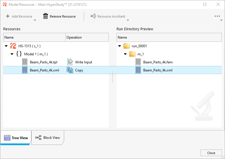

  6. Define a model dependency.
    1. Click Model Resources.
    2. Select Model 1(m_1).
    3. In the Model Resource dialog, click Resource Assistant > Add File.
    4. In the Select File dialog, navigate to your working directory and open the Beam_Parts_4k.xml file.
    5. Set Operation to Copy.
    6. Click Close.

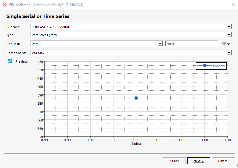

    2. In the File Assistant dialog, set the Reading technology to Altair® HyperWorks® (ResultModule XML Reader) and click Next.
    3. Select Single Item in a Time Series, then click Next.
    4. Define the following options, and then click Next.
      • Set Subcase to SUBCASE 1 = 1.33 deltaP.
      • Set Type to Part Stress (Part).
      • Set Request to Part 22.
      • Set Component to VM Max.

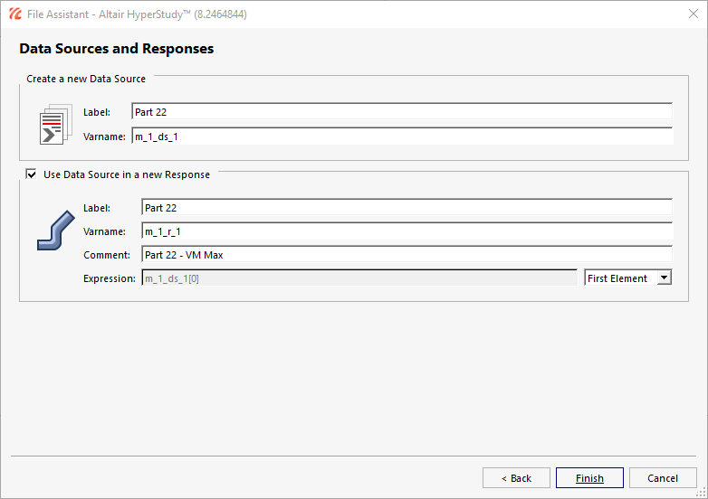

      Figure 4.
    5. Label the output response Part 22.
    6. Set Expression to First Element.
    7. Click Finish.
      Figure 5.
    The Part 22 output response is added to the work area.
