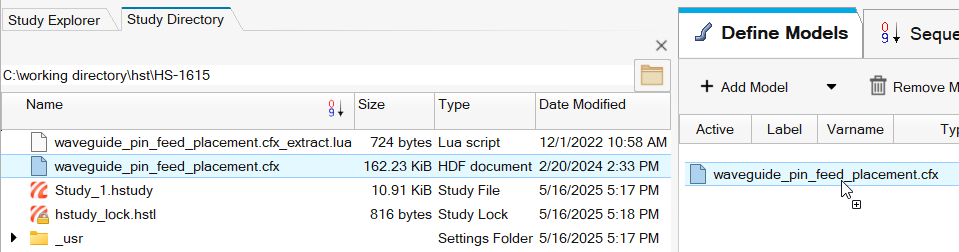

  5. Add a FEKO model by dragging-and-dropping the waveguide_pin_feed_placement.cfx from the Directory into the work area.
    The Resource, Solver Input File, and Solver Input Arguments fields become populated.

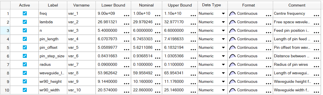

  6. Click Import Variables.
    Ten input variables are imported from the waveguide_pin_feed_placement.cfx file.
  7. Go to the Define Input Variables step.
  8. Review the input variables.

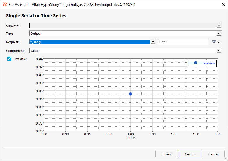

    3. Select Single Item in a Time Series and click Next.
    4. Define the following and click Next.
      • Set Type to Output.
      • Set Request to z_Imag.
      • Set Component to Value.
      Figure 3.

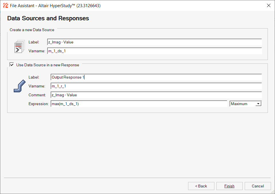

    5. Enable the Use Data Source in a new Response checkbox.
    6. Enter labels for the data source and output response as shown in Figure 4.
    7. Set the output response Expression to Maximum.
    8. Click Finish.
      Figure 4.

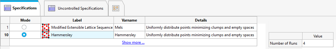

  5. In the work area, set the Mode to Hammersley.
  6. In the Settings tab, change the Number of runs to 4.
    Figure 5.

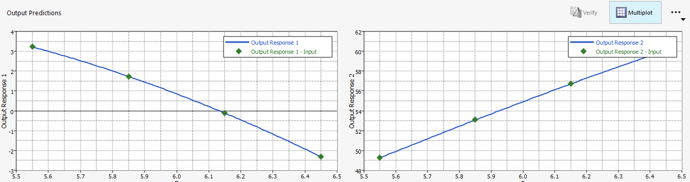

  7. Plot the response surface.
    1. Click the Trade-Off tab.
    2. Using the Channel selector, select both output responses.
    3. From the Inputs section, enable the X Axis checkbox.
    4. From the Output Plots section, select (Multiplot).
    Figure 6.
