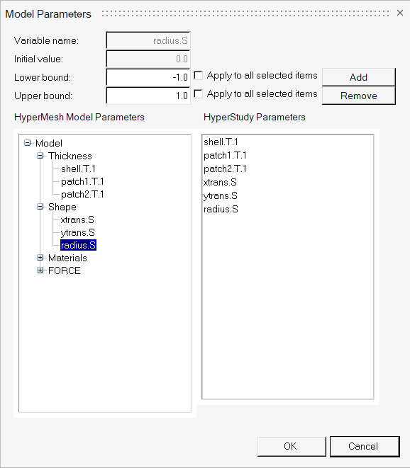

    The Model Parameters dialog opens.
  3. In the Model Parameters dialog, add variables as shown in Figure 1 and click OK.

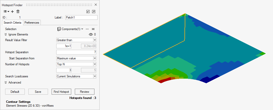

  7. In the Hotspot Finder dialog, click to add a Patch1 component (for Label) to the current HyperView session.
  8. Query Patch1 hotspot by repeating step 6.
    1. For Label, replace Shell with Patch1.
    2. In the modeling window, select the Patch1 component.

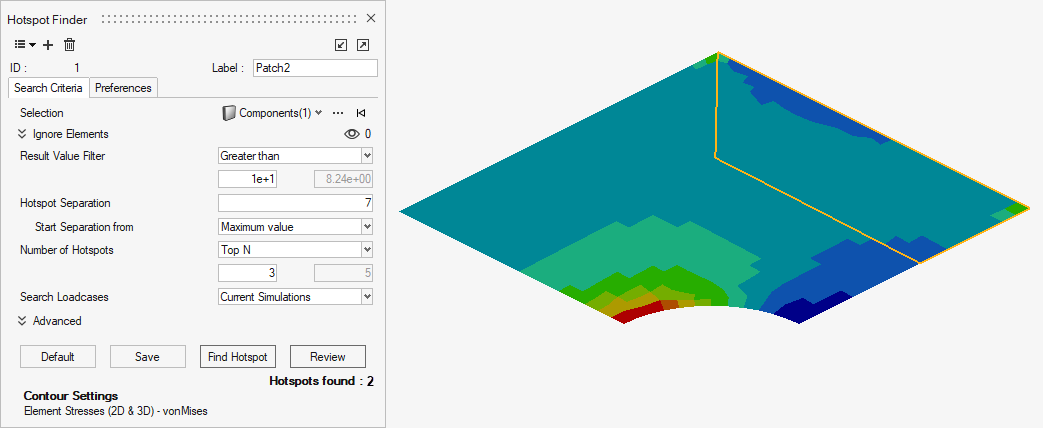

  9. In the Hotspot Finder dialog, click to add a Patch2 component (for Label) to the current HyperView session.
  10. Query Patch2 hotspot by repeating step 6.
    1. For Label, replace Shell with enter Patch2.
    2. In the modeling window, select the Patch2 component.
    Figure 4.

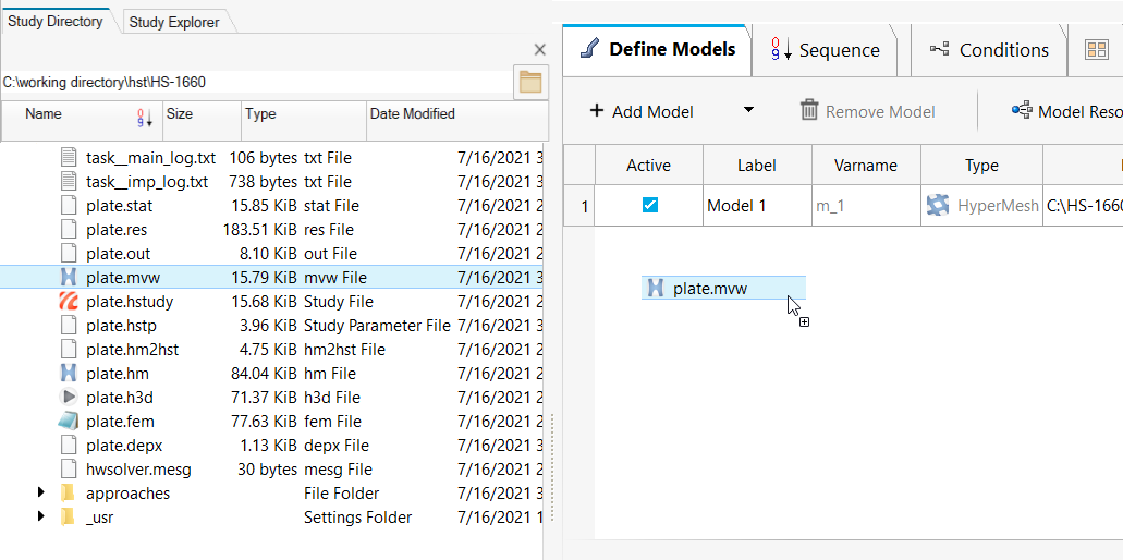

  1. From the Directory in HyperStudy, drag-and-drop the plate.mvw file into the Define Models area.
    Figure 5.
  2. Click Import Variables.

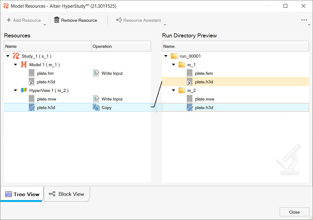

  3. In the Define Models area, click Model Resources.
    The Model Resources dialog opens.
  4. In the Model Resources dialog, define a model dependency that references the result file from m_1 directory, plate.h3d to be used as an input for the HyperView model.
    1. Select Model 2 (m_2).
    2. Click Resource Assistant > Add File.
    3. In the Select File dialog, navigate to the m_1 directory and add the plate.h3d file.
    4. Set the plate.h3d operation to Copy.
    Figure 6.
  5. Close the Model Resources dialog.

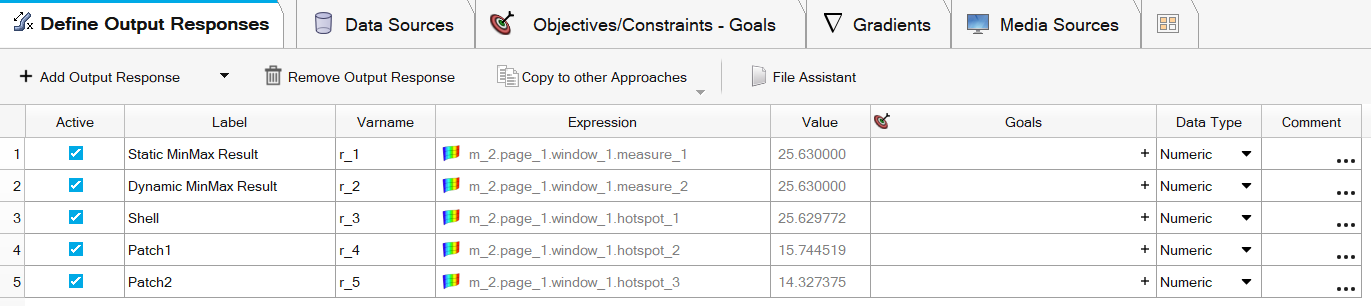

  7. In the Define Output Responses step, review the hotspot responses.
    Figure 7.
