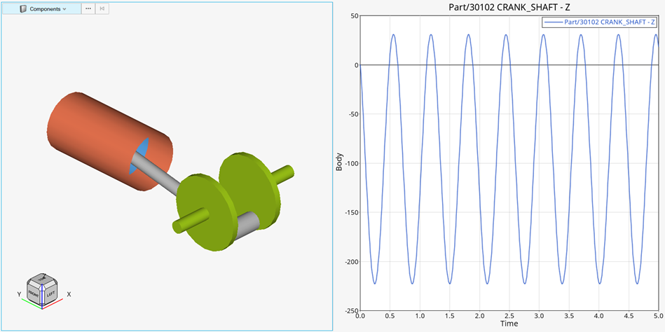

Once the solution is completed, the results can be visualized using the Animate button in the Run status window. A HyperView (Animation client) window is added and a result file is loaded.
From the Animation toolbar, click the Start/Pause Animation button
to visualize the
animation.
Results can also be plotted using the Plot button in the MotionView Run status window. A HyperGraph (Plot client) window is added with the plot file (.abf) corresponding to the run loaded.

Animate Results Files
- Select the Load Model panel from HyperView.
Select a model file and a results file and click
to begin animation.
Plot Results Files
- Select the Build Plots panel from HyperGraph.
- Select the output file.
- Select the signals of interest.
- Click Apply.
