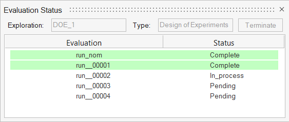

  6. Click Run.
    The Evaluation Status dialog opens. Here, you can track the progress of each run.
    HyperMesh creates run files in the approaches directory.
