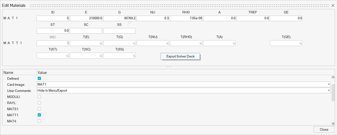

Export a Solver Deck from the Card Editor
Export the selected card to the solver deck.
Right-click within the Card Editor and select Export Solver Deck from the context menu.
