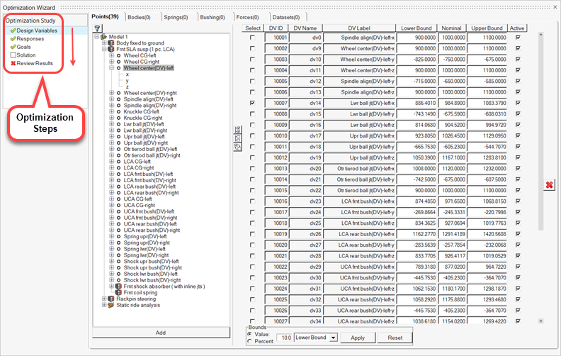

The above steps are encapsulated in the Optimization Wizard in MotionView 2025.1. This wizard provides an intuitive and step-by-step approach to performing the above steps. The Optimization Wizard can be accessed by:
  • Right-clicking on Model in the Model Browser and choosing Optimization Wizard
    OR
  • From the Analyze ribbon, Optimize tool set, click the MotionSolve icon.
Once launched, the Optimization Wizard (shown below) guides you with the setup and solution of the optimization problem in a step-by-step manner.
The wizard ensures that you will complete steps in a specific order. You cannot move to the next step without completing the current step. The state of each step is indicated by one of the symbols shown below.
A red cross indicates that this step cannot be accessed; you have to complete the previous step(s) to perform this action.
An empty check box indicates that this is the current step that you are working on.
A green check mark indicates that this step has been sufficiently completed and you can proceed to the next step.
