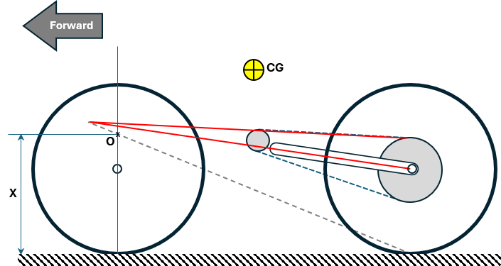

Calculating Anti-Squat
In the Two-Wheeler models that you can assemble using MotionView Vehicle Tools, a geometric method is used to calculate the ‘anti’ parameters.
Note: Anti-squat is calculated only for rear suspension in the models built using the Assembly Wizard.
The Anti-squat for a suspension is calculated using the: swing-arm, top chain run, vehicle CG height and the tire contact patches.
Imagine a line drawn from the rear wheel center through the swing arm pivot, and another line drawn along the top chain run. These two lines intersect at some point ahead of the swing arm pivot. Join this point of intersection with the rear tire contact point using a third line. Draw a vertical line from the front tire contact point to intersect the third line at “O”. The height of this point “O” expressed as a percentage of the CG height is the anti-squat value.

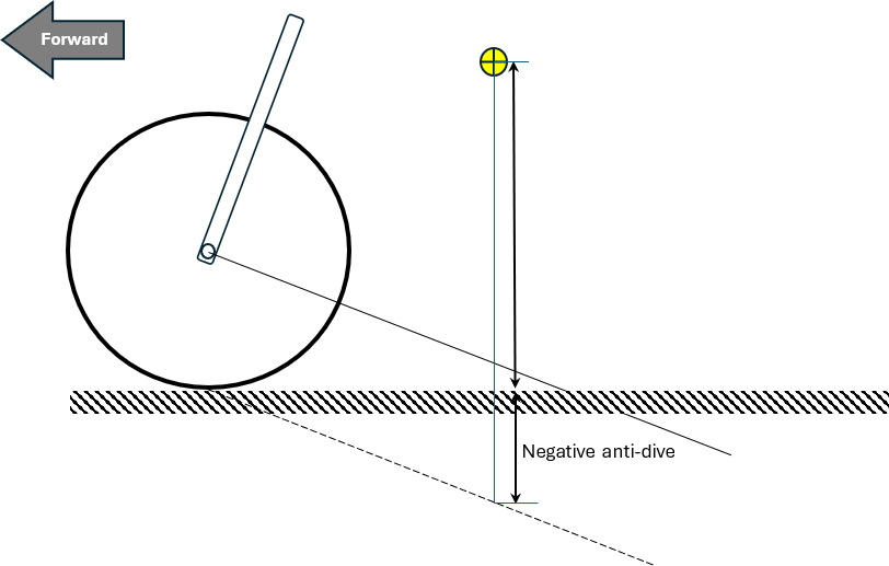

Calculating Anti-Dive
The anti-dive is calculated based on the assumption that the front fork acts as a virtual swing arm. The calculations explained here are only applicable for telescopic forks.
Note: Anti-dive is calculated only for front suspension in the models built using Assembly Wizard.
The telescopic fork acts like a swing arm with infinite length that extends in a direction normal to the rake angle. Imagine such a line drawn from the wheel center. Draw another line parallel to this but from the tire contact point to intersect with the first line. Drop a vertical from the vehicle CG to intersect both the virtual swing arm and the line from tire contact point.
The portion of this line below the ground/road surface as a percentage of the CG height is the anti-dive. Because this is below the road surface, the value is negative in this case.

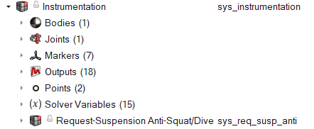

Anti-Squat/Dive Output Requests in Two-Wheeler Models
When you build a Two-Wheeler model using Assembly Wizard, the Anti-Squat and Dive outputs are included in a separate system called Request-Suspension Anti-Squat/Dive.
Figure 3.

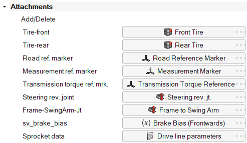

This system contains the output requests that you can plot after a simulation. The entities that are necessary to measure the antis are included as attachments to this system.
Figure 4.
Solver variables are created to calculate the parameters required for calculating anti-squat/dive.
