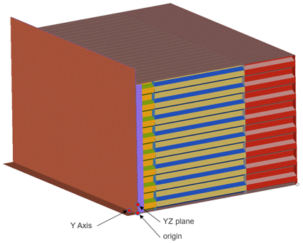

  4. Use the Origin, Y-Axis, and YZ plane node selectors to define the system at the back of the barrier frontal block, which will be the reference system for the projection calculation.

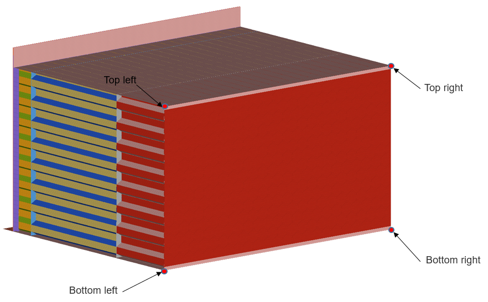

  5. Use the Top right, Top left, Bottom right, and Bottom left node selectors to select the four corners of the front face of the barrier.

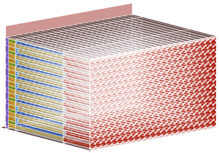

  6. Select the whole components defining the full barrier block.

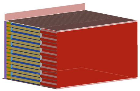

  7. Select the outer cladding components of the barrier block.
