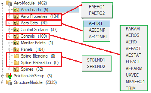

The Aero Module, SolutionJobSetup and StructureModule folders organize all of the keywords used to define the aerospace model and setup the solution job. Right-click on a folder and select Create from the context menu to begin creating cards. Use the Entity Editor to define each of the corresponding attributes for the cards.
Aero Module
The Aero Module folder organizes all of the keywords that define the aerospace model.
SolutionJobSetup
The SolutionJobSetup folder organizes all of the keywords used to setup the solution job. The Case Controls child folder organizes keywords used to define input controls, solution output controls, global case control loads and subcase control loads. The Executive Controls child folder organizes keywords used to define the required solution sequence. Supported solution sequences include:
  • SOL 144: Static Aeroelastic Response
  • SOL 145: Aerodynamic Flutter
  • SOL 146: Dynamic Aeroelastic Response
StructureModule
The StructureModule folder organizes all of the control structural entities needed for the structure definition. Using the browser you can also define or edit structural entities.
Required Nastran entities are supported to setup the model for the solution sequences. A user interface is available to create/edit each of the definitions. Use the Aeroelasticity Browser to create, modify and manage:
  • CAERO1 panels (as special components)
  • Splines (SPLINEx)
  • Monitor Points (MONPNTx)
  • Control Surfaces (AESURF)
  • Sets and Groups (AELIST, SET1, AECOMP)
  • Flight load definition, such as GUST, FLUTTER and AEFORCE
  • AERO/AEROS configuration data, such as ref chord and area
  • Factor table data, such as AEFACT, FLFACT, MKAEROx, UXVEC and TRIM

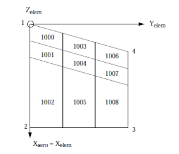

  1. Define your own ID and Title by overriding the default values.
  2. The image icon provides more information about the numbering system and pattern to be followed while meshing CAERO1. For example, the start node and element ID should be the same as the component ID. Numbering should be sequentially incremented in the chord direction and continued in the span direction.
  3. Define the Flow Direction.
  4. Mesh control can be done by selecting tables (AEFACT tables) for chord and/or span. You can either select number of chords or span elements. Chord is the direction along flow (point 1 and point 2). Span is the direction along point 1-4.
  5. You can select Point1 (origin). Location information is extracted from the selected point/node, and the same can be modified by editing the text field.
  6. For the edge length 1-2 and 3-4, you can select the location by node or point. The selected location information is used to calculate edge length only.
  7. Point four is used to find the spanning direction and spanning length 1-4.
  8. After you select all of the necessary data, clicking Create Mesh will mesh the selected domain with AEGRID nodes and AEQUAD4 elements. Per solver requirements, nodes and elements are not explicitly exported into BDF, but other references such as SPLINE, AEGRID AESURF will have their reference.

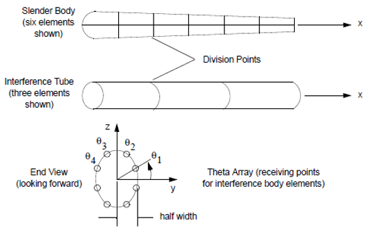

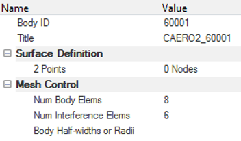

Aero Body (CAERO2)
This tool provides a quick and convenient way to define the body type of aerospace meshing called CAERO2.
  • The Body ID and Title are defined by default. You can change these.
  • Selection of two points define the axis of the body
  • Mesh controls can be defined to identity number of body. Interference elements can be defined and internally required AEFACT tables will be created for the solution.
  • Half width is the radius of the body at different locations. Varying cross sections can be defined by providing a comma separated half width in the Num Interference section. Missing data will be repeated with lost data entered.

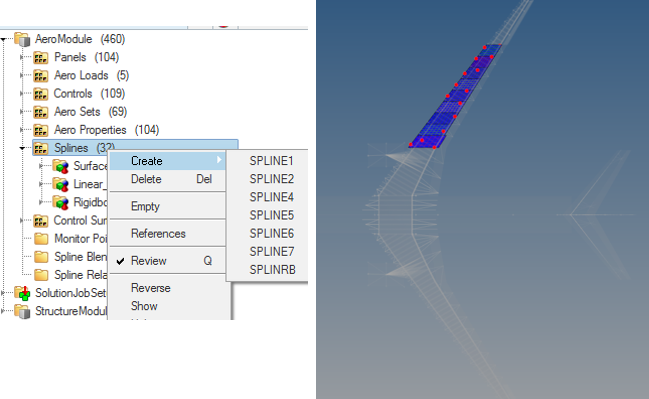

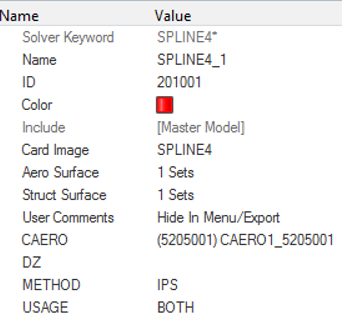

Splines
This section defines the SPLINEx type of entities to transfer the aerospace load to structure. The entity definition can be done using the Aeroelasticity Browser.

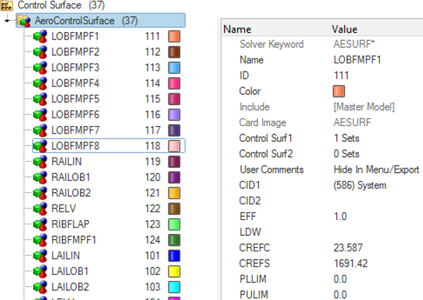

Aero Control Surface Definition
You can identify moving bodies in the wing and stabilizer area. The Aeroelasticity Browser and Entity Editor are used to define controlling surfaces and data required.

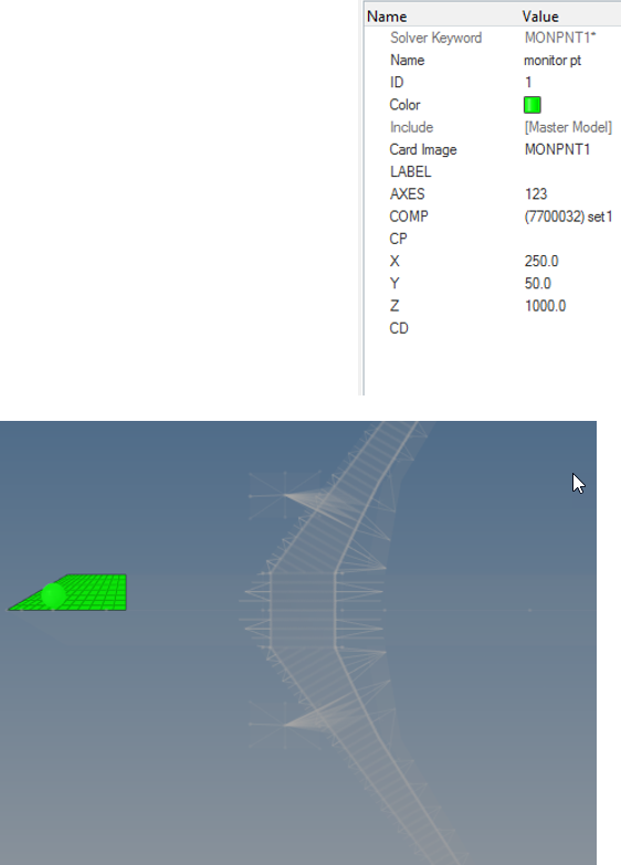

Monitor Point Definition
Result monitor point definition can be done for all types of MONPNTx types.
