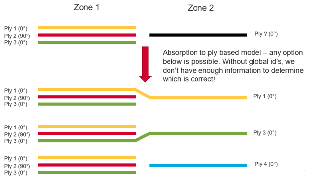

Exact conversion of the zone-based model to ply-based model depends on the existence of global ply IDs/names on the zones, for example PCOMPG instead of PCOMP. FE Absorb Plies will still run with zones that do not have global data, for example PCOMP, but the conversion relies on internal logic to determine how to connect plies from zone to zone.

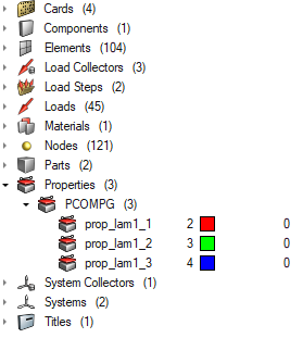

    These FE models do not have any plies or laminates. The goal is to create plies and laminates from the zone-based solver properties.
    Figure 2. No Plies or Laminates are in the FE Model

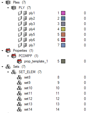

    After the conversion, laminates and plies are created. However converting a zone-based model to a ply-based model is not deterministic if global IDs or names are not defined in the properties. Many possibilities exist, especially the laminate stacking order. You are advised to check the laminate and reorder, if necessary.
    Figure 3. Ply, Laminate, and PCOMPP are Created in the Model after FE Absorb
