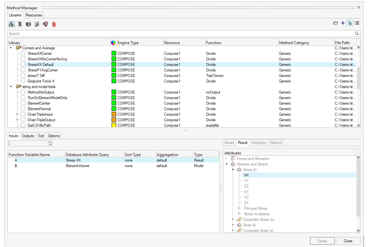

The Method Manager is a notebook with two sheets (Library or Resources).
Figure 1. Library Editor (Normal Mode)
Figure 2. Library Editor (Edit Mode)

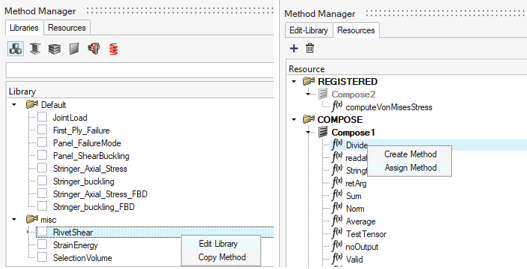

Create Method & Assign Method
Function level
Create is enabled only if a library is in edit mode; it adds a new method in the current library, using the function/resource from which it is invoked. Assign is enabled if a method is currently edited. As a result, it updates the current method to refer to the function from which the menu is invoked.

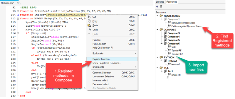

It is also possible if an *.oml file is edited in Altair Compose to use Register Function in Compose to directly make it available in the list of registered functions in the Resources tab.
Figure 3. Register OML Function

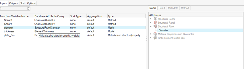

Figure 4. Attribute Mapping Review
Selecting an attribute in the list shows its mapping and Type. Hovering the mouse on the row shows in the tooltip the resolved key queried by the engine. Attribute Type can be:
  • Undefined
    • Parameter unresolved
    • Status color red
    • Method selection is disabled (cannot be created from the template)
  • User
    • Parameter defined locally inside the library file
    • Value shown as a tooltip only
    • Takes precedence over any built-in parameter
  • Model
    • Parameter found in pre-defined list of model attributes
    • Populates the Model tab
    • Not overwritten locally in the library file
  • Result
    • Parameter found in pre-defined list of result attributes
    • Populates the Result tab
  • Metadata
    • User input
    • Populates the Metadata tab
  • Method
    • Parameter coming from another method
    • Implies that this method run along the selected method
    • The status color is orange due to dependencies
      • Independent methods are listed in hierarchy under caller

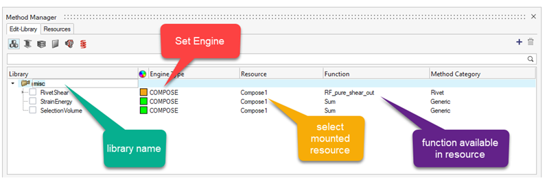

Edit Library
Edit Library is available on a library node (except Default) or method and puts the Library tab in edit mode. The browser is populated only with the given library (works with Session too). Alternatively, you can double-click a method/library to reach the same state.
Note: Editing capabilities are available only when the browser display method is in hierarchy view .
The / icons add or delete methods. New methods inherit their category from the current config set in the display filters.
  • Default engine is “COMPOSE”
  • Default function is the first registered function if any exist
  • Otherwise, it defaults to the first COMPOSE resource and points to its first function
At this point, you can fully edit the method (see Edit Methods).

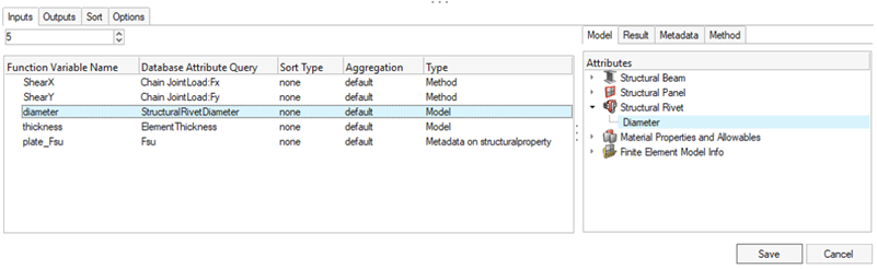

You can edit an existing method by double-clicking a method name or library name to enter Edit mode. Method is then active.
Figure 6.
You can assign a function from the available resources in the Resources tab when library is in Edit mode. Otherwise, you can click Engine > Resource > Function from the menu in the method list.
Figure 7.
