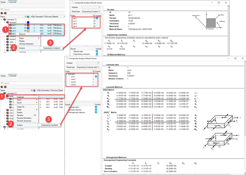

Engineering Constants
Engineering constants and relevant material/laminate matrices can be calculated for:
  • Materials
  • Plies
  • Zones
  • Laminates
  • Elements
Dependent on the selected entity type, different analyses are executed upon selection of Engineering Constants.
  • Selection of multiple entities of the same type is also supported and generates a list in the Composite Analysis Result Viewer, from which desired results can be selected.
  • Only one analysis entity can be selected and run at a given time. All analyses’ results can be accessed via the Analysis combo box in the Composite Analysis Result Viewer.

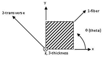

Calculations are output in the laminate’s material reference orientation. Accordingly, the ply angle entered in the ply Orientation field is used to transform the properties from ply fiber direction to the laminate material reference orientation. For more information, refer to Fiber Orientation.

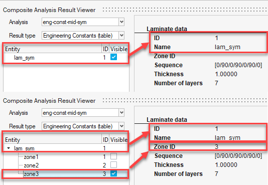

If all plies of a laminate have an assigned shape, the analysis is provided for all zones of the selected laminate. If one or more plies in a Laminate do not have a Ply Shape assigned, no Laminate Zones are generated. Accordingly, laminate calculations are provided for the full stacking sequence as defined in the laminate.

Generally, Engineering Constants results are available in tabular form or as a plot. You can select the result type via the Result type combo box in the Composite Analysis Result viewer.
Figure 4.
Line plots illustrate the selected properties over a range of angles. Multiple entities and results can be selected, and lines are named accordingly. For materials, the range represents an actual orientation of a material. For plies, the range refers to an orientation change with respect to the orientation defined on the ply. And for laminates, the range refers to the laminate rotation from its reference. Hovering over a line will activate the tool tip, showing the numerical value of the selected point (results are available in 1° steps).
Figure 5.

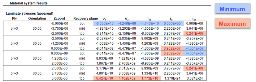

Generally, Load Response/Failure results are available in tabular form, as a through-thickness plot or as contour. You can switch between table and through-thickness plot via the Result type combo box in the Composite Analysis Result viewer. Post-processing for contouring is available when selecting elements as entity.
Figure 6.
Table minimum and maximum values are indicated by blue and red cell background to quickly spot the extreme values of each result. For first ply failure calculation, the failure index is an exception. Here the failure index, which leads to the critical reserve factor, is marked red and the least critical is marked blue, see Figure 7.

  • Material system stresses for each ply
    • Apparent
    • Mechanical
    • Thermal residual

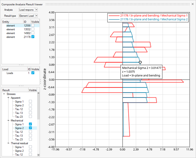

Through-thickness plots illustrate the results (one at a time) at the recovery planes of the various plies of the laminate. Tool tips are available at reach result to retrieve the exact numbers. Lines for each ply are colored with the corresponding ply color, when only a single selection is active for an entry, load and result. The selection of multiple laminates or elements, loads or load cases, and results allows for easy comparison.

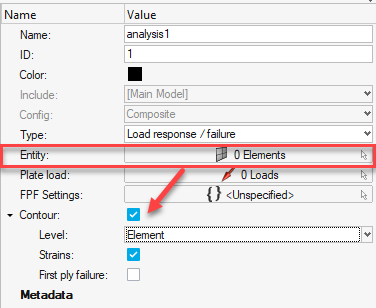

Contouring results include:
  • Element mid-plane strains, first-ply-failure margins and critical ply ID
  • Ply recovery planes’ (middle, top/bottom, top/middle/bottom) stresses and strains in corresponding ply material system, and first-ply-failure margins

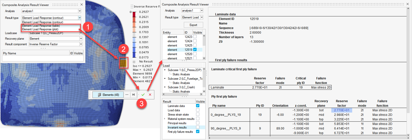

Elements can be selected from the contour plot for detailed post-processing with full tabular results and through-thickness plots after picking the corresponding option from the Result type drop-down menu as outlined in Figure 9.

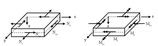

Forces and moments are defined as illustrated below. Moment definitions are opposite of the ones in OptiStruct and Nastran.

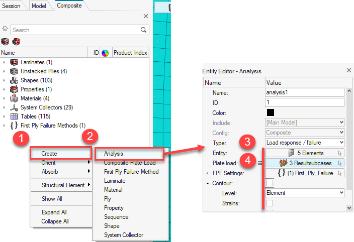

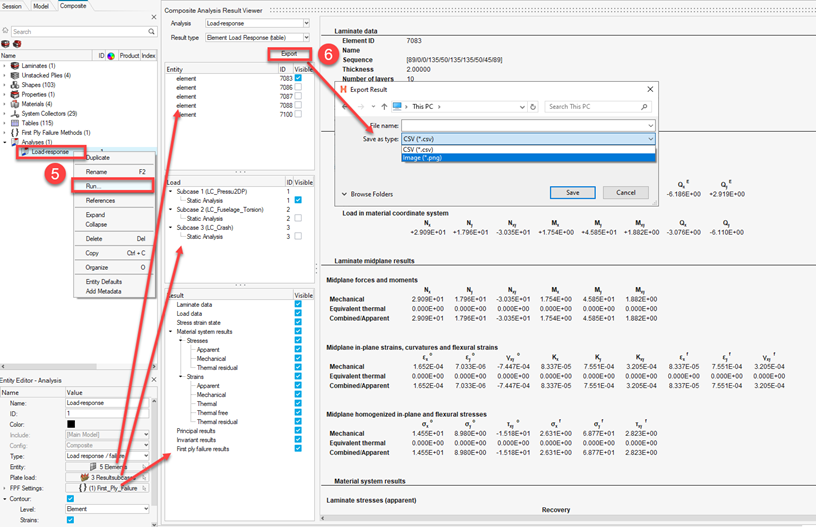

To set up and run an analysis:
  1. Create and edit all participating entities (materials, plies, laminates, composite plate loads, first ply failure methods).
  2. Right-click in the white space of the Composite Browser or the Analyses folder to create an analysis entity.
  3. Select the analysis type.
  4. Select participating entities according to analysis type.
    Figure 11.
  5. Run using the analysis’ right-click menu option Run….
    In the result view, combinations of entities and results can be picked. When any of the participating entities are changed, the analysis must be run again.
  6. Export results from the Composite Analysis Result Viewer to .csv file for numerical results and line data of plots, as well as .png image file for the plots themselves.
    Image files will be saved in the same size as displayed in the viewer at export time. Numerical (table) results from the Composite Analysis Result Viewer can be copied to the clipboard via the Ctrl > C keyboard shortcut or via the context menu available in the result display area.
