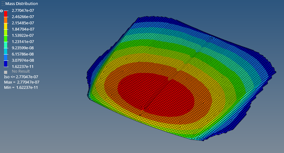

Note: A special Review is available for Solver Mass entity with Mass Type=5. It displays the mass distribution on all the nodes referenced in the Solver Mass, with a dynamic legend:
