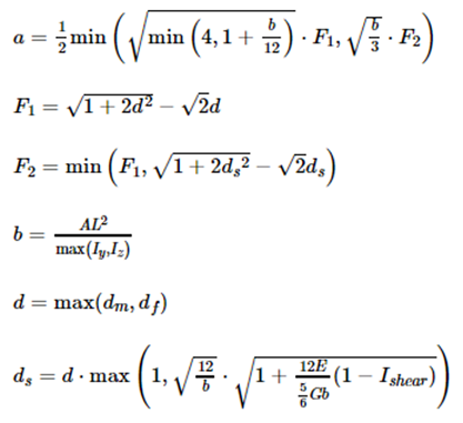

Critical Time Step for Beam (1D) Elements
Critical time step:
Figure 6.
Where, L is the characteristic length and 𝑐 is the sound speed.
Figure 7.
Where, E is Young’s modulus and ρ is Material density.
Figure 8.
