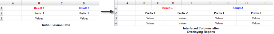

When you select an area from the table to interlace columns, all cells above and below the selected area will be merged cells. In other words, they will be expanded horizontally to accommodate the new columns beneath/above them.

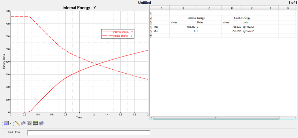

Create or load a session file that contains your data.
For example, the following session displays the internal and kinetic energy data in TableView (right side of image) for the curves shown on the left:
Figure 6.

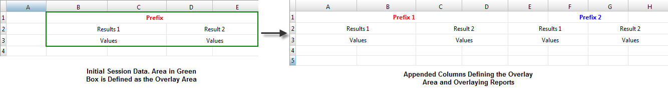

From the Table ribbon, select the Overlay tool.
- From the Overlay Mode drop-down menu, select Append as Columns.
Click Add Overlay Area.
Overlay 1 is added to the Overlay Area Name column.
Under the Cells column, click inside the empty cell.
The selector icon is displayed.

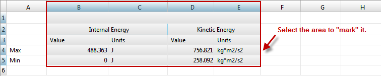

Click the selector icon, and with the left mouse button, drag and select the
cells in TableView that contain the previously loaded
data.
Figure 7.
Figure 8. The cells you marked are displayed in the dialog below:

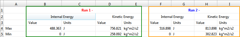

Run 2 data is appended next to the Run 1 data.
Figure 10.

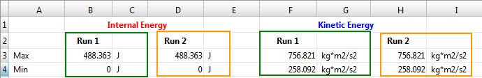

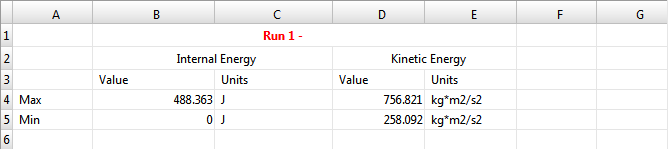

Interlacing Columns
If you choose to interlace data, or Insert as Columns instead of Append as Columns, the procedure varies slightly.
For example, start with the same session data as when appending data.
Figure 11.

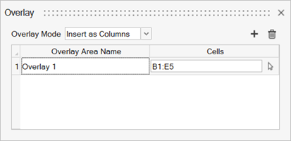

However, when you select Insert as Columns for the Overlay Mode, you will have
two overlay areas defined, as shown below:
Figure 12.
After you define the overlay area, return to the Open Session and Set
Parameters dialog and edit your report template:
- Select a new PLOT_FILE.
- Change the color.
- Change the prefix (for example, to Run 2).
- Under Mode, select Overlay.
Click Apply.

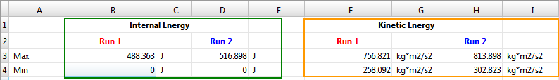

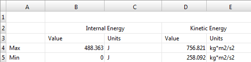

The image below shows the data for Run 1 and Run 2 side-by-side under each heading.
Figure 13.

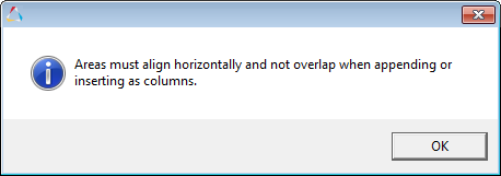

Note: Existing cells (in the original table) will not be modified/affected when the overlay is performed.When more than one area in the table is selected for an overlay, the selected areas must align horizontally when overlaying by column and vertically when overlaying by row. In both cases, the selected areas must not overlap. When more than one area in the table is selected, if the second area overlaps or does not align properly with the first, a message similar to the one below is displayed as soon as the second area is selected and you will not be allowed to select that area:
Figure 14.
