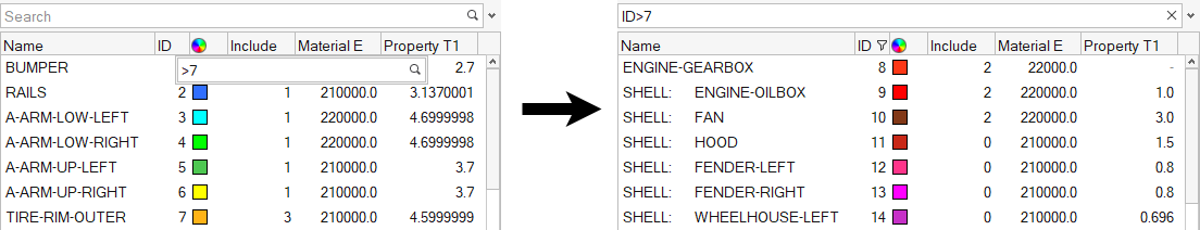

    2 or "2" All entities with the ID 2.
    1-4 All entities with the IDs in range 1 to 4.
    1,5,9 All entities with the IDs 1, 5 and 9.
    ID=2* All entities with IDs that start with the number 2.
    ID=*2 All entities with IDs that end with the number 2.
  2. Press Enter or click to execute the search.

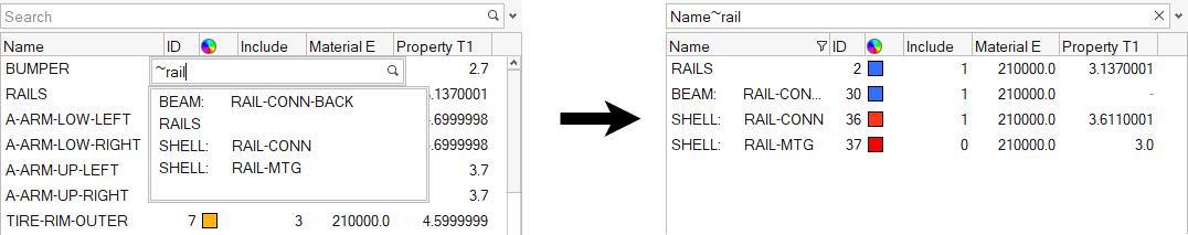

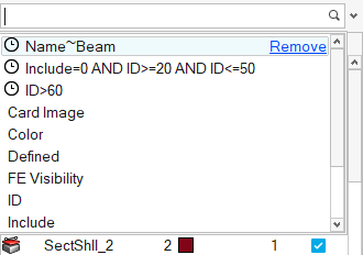

Perform an Advanced Search Using Auto-completion
Interactively build search strings using a dynamic suggestion list.
  1. Access the list by clicking the text field of a browser search bar.
  2. Select attributes, operators, and values to append the correct syntax to the search string.
    The search syntax follows this basic form: <attribute> <operator> <value>.
    Figure 3.
    Note: The attributes available in the list are the same as the current active browser attributes (columns). If you do not see an expected attribute, make sure the corresponding browser column is turned on.
    Entering this queryReturns this result
    Name~Bpillar Entities that contain Bpillar in their name
    Name!~Bpillar Entities that do not contain Bpillar in their name
    ID~5 Entities with an ID that contains the number 5.
    ID!~5 Entities with an ID that does not contain the number 5.
    Name=Bpillar Entities with the name Bpillar
    ID=10 Entities with an ID equal to 10
    ID!=10 Entities with an ID not equal to 10
    ID IN(5,10,15) Entities with an ID equal to 5 or 10 or 15
    ID NOT IN(5,10,15) Entities with an ID not equal to 5 or 10 or 15
    ID=100-250 Entities with an ID in the range of 100-250
    ID!=100-250 Entities with an ID not in the range of 100-250
    ID=8*3 Entities with IDs starting with 8 and ending with 3
    ID=[0-9][0-9][0-9][0-9][0-9]6 Entities with IDs ending with 6 in 6-digit numbers
    ID=[0-9][0-9][0-9][0-9]2[0-9][0-9][0-9] Entities with IDs with 2 at the 5th position in 8-digit numbers
    Entity=Properties AND ID>10 Properties with an ID greater than 10.
    Entity=Properties OR ID>10 All properties and other entities with an ID greater than 10.
    ID>=10 AND ID=<20 AND Name~Bpillar Entities that contain Bpillar in their name and have an ID greater than or equal to 10 and less than or equal to 20.
    Include=1 AND Material E=210000 OR Material E=220000 Materials with E=210000 under Include1 and Materials with E=220000 under all other includes.
    Include=1 AND (Material E=210000 OR Material E=220000) Materials with E=210000 and E=220000 under Include1.
    Include=1 AND Material E IN(210000,220000) Materials with E=210000 and E=220000 under Include1.
    Include=1 AND Property T NOT IN(1.5,3.5) Properties with Thickness not equal to 1.5 or 3.5 under Include1
  3. Press Enter or click to execute the search.

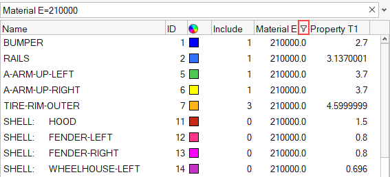

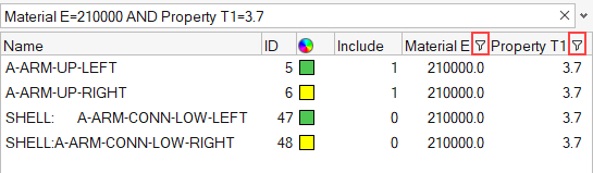

Use Column Filters to Build a Search
Use column filters to quickly search any attribute that is added to a browser as a column.
  1. Hover over a column name then click the filter icon .
  2. Type a value or select from the suggestion list then press Enter or click .
    The value entered is converted to the correct syntax and shown in the search bar.
    Figure 4.
    You can also use operators in the column filter to refine the search.
    Figure 5.
    A column filter icon indicates the column on which the filter is applied.
    Figure 6.
    Multiple column filters can be applied. The search string is appended in the search bar.
    Figure 7.

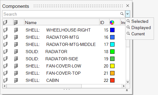

Use Predefined Filters to Build a Search
Use predefined filters to quickly filter the browser contents with selected or displayed entities
Predefined filters are supported in Model Browser entity views, the Part Browser, and the Subsystem Browser.
  1. Access the list of predefined filters by clicking the drop-down button next to the search icon.

    • Selected - Filters the browser with just the selected items. The Selected filter works for selection in both the browser and the graphics and should be reapplied after appending an existing selection.
    • Displayed - Filters the browser with entities that are displayed in the graphics. When the Displayed filter is applied in a browser, the filtered results are automatically updated upon changing the display state of the selected entities.
    • Current - Filters out the current collector.
  2. Clear the search and return to the default browser view in the following ways:
    • Delete the search and press Enter.
    • Click x.
    • With the cursor's focus on the search bar, press Esc.
Tip: After applying predefined filters, the search string can be further appended with more arguments to refine the search results.
Access Recent Search Strings
Click the text field of a browser search bar.
Your recent searches are indicated by the icon.
Figure 9.
Clicking on a recent search string auto-applies the filter and shows the search string in the search bar.
Clicking Remove removes the selected search string from recent history.
Note: A maximum of 5 recent searches are shown. Remove the latest strings to see previous search strings.
