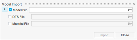

  1. From the SnRPre ribbon, Setup group, select the Import tool.
    The Model Import dialog opens.
  2. Click to select a model to import.
  3. Optional: Click to specify DTS and material files.
  4. Click Import.
    Note: Once the files are specified, Squeak and Rattle Director will make a copy of these files to a working directory in the same directory as the model file. The name of the working directory will follow the name of the model file and suffixed with _SNRD. For example, if the model file name is SnR_demo_model, then the name of the working directory will be SnR_demo_model_SNRD.
    The selected model, default, or DTS, and material files are imported to the HyperMesh Desktop session.

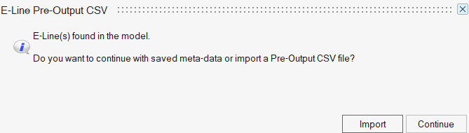

  • For a new model, you can start the E-Line Setup.
  • For a model with existing E-Lines, all previously created E-Lines will be visible in the model.
  • If a model contains existing E-Line(s), you have an option to restore E-Lines information from a pre-output CSV file or from the data stored in the file itself. The latter option is only available for .hm files.
    Restriction: Existing E-Lines in a Solver Deck can not be restored without a pre-output CSV file, which can only be created at Export. Save the progress in the .hm file.

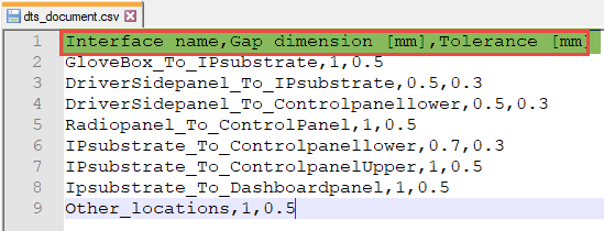

DTS File
The user-defined Material database is imported, and you can map material to corresponding squeak lines in the Manage E-Line tool.
A Dimension Tolerance Specifications (DTS) file is a *.csv file containing the manufacturing tolerance between the components in the model.

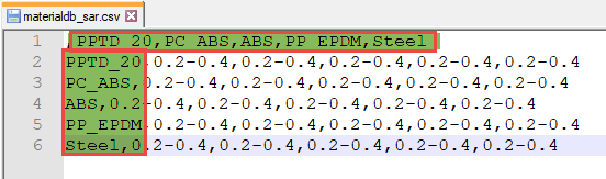

Material File
A Material file is a *.csv file containing the user-created material stick-slip data.
Figure 5.
