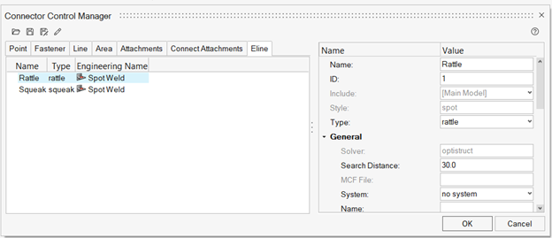

The creation of E-Lines is controlled by a set of E-Line properties, also called a control. Controls for rattle and squeak evaluation is predefined based on best practices; you will select which to use at the creation of E-Lines. You have the option to modify the default controls or create a new custom control through the menu shown in Figure 1.
Figure 3.
Learn more about the Connector Controls workflow. The initial creation of an E-Line is defined by the properties on the control, each E-Line can be individually modified after creation through Manage E-Lines. Properties relevant to the creation of E-Lines can be found here.

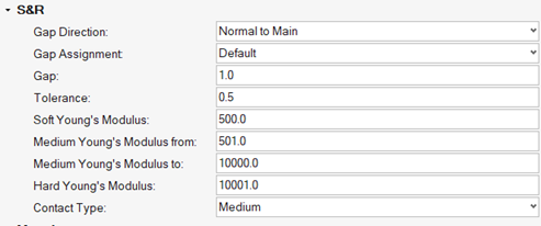

General E-Line Properties
Spacing
Defines the spacing between the E-point placements along the created E-Lines.
Search Distance
Defines the tolerance or search distance between interface components/parts.

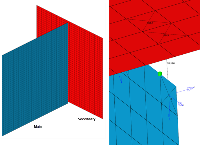

Gap Direction
Realization Projection direction.
Normal to Main
Z direction will be perpendicular or Normal to Main component.
Figure 6.

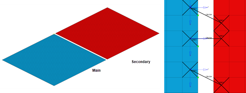

In Plane to Main
Z direction will be In Plane to Main component.
Figure 7.
Gap Assignment
Defines which method to use to assign Gap and Tolerance values to E-Lines. The assigned gap and tolerance values can be reviewed in E-Line Review Table.
Default
Predefined template values are assigned.
From DTS File
Values from imported DTS file are assigned (default, if DTS file was imported).
From FE-model
Gap value is determined based on the distance between two components in the projected direction.

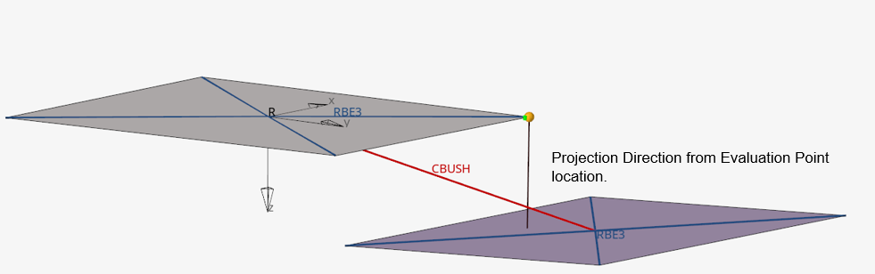

Calculated Gap
Distance between two components in the projection direction, averaged along the E-line.
Calculated Gap = Projection Direction Distance - (Thickness Comp 1 + Thickness Comp 2)/2
Figure 8.
Gap
Gap value for the interface in the specified gap direction. Defined based on the Gap assignment method.
Tolerance
Design tolerance for gap in the specified gap direction. Defined based on the Gap Assignment method.

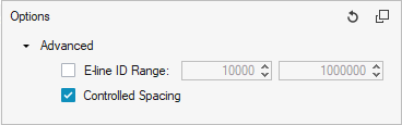

Advanced
There are several additional advanced options that can be defined via the options menu which controls the creation of E-Lines further.
Figure 9.
E-line ID Range
Define an ID Range for created E-Lines and all entities belonging to them.
Controlled Spacing
Define a limit on the spacing to avoid error in solver and numerical issues.
