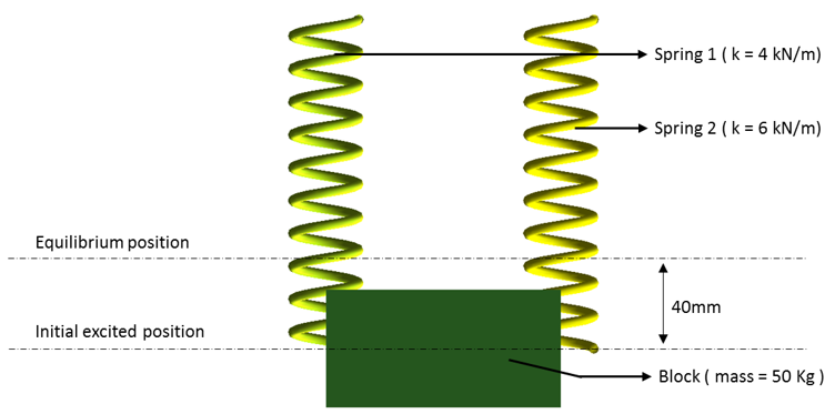

The objective is to find the natural frequency of the spring mass system as shown in the figure below.

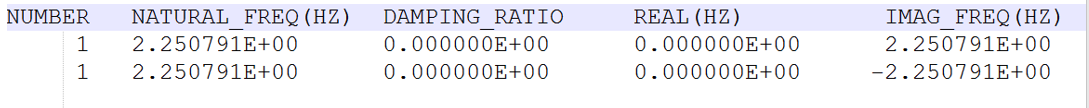

Eigen File Results
Result Comparison
| Output | Analytical | MotionSolve | % Error |
| Natural frequency (Hz) | 2.250791 | 2.250791 | 0% |
Conclusion
MotionSolve results compare well with the analytical results.
