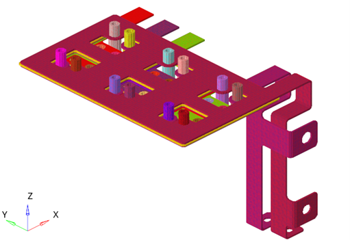

Busbars are commonly used in many applications to provide power to various electronic boxes.
The model consists is an electrical system with five circuits. The circuits are separated from each other using a thin di-electric layer.
An initial temperature of 20 degrees Celsius is applied to all the bodies.

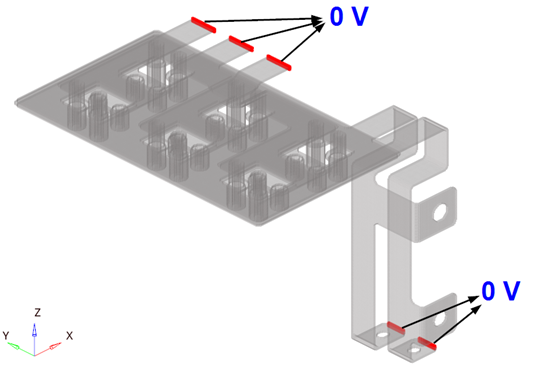

Point currents are specified using the CURRENT Bulk Data Entry at the terminals, while 0V voltage is applied using SPC.
Figure 2. Boundary Conditions on Busbar Model. Zero potential is applied as shown in red

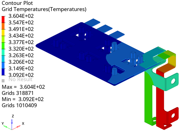

The temperature distribution on the model is:
Figure 3. Temperature Distribution on Busbar

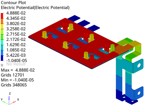

The electric potential on the model is:
Figure 4. Electric Potential on Busbar
