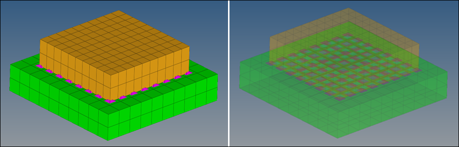

Contact between the main and secondary surfaces can be constructed through three main approaches. This process is called discretization, and it defines the basic structure of the contact elements that are constructed to handle the contact condition.
Node-to-Surface Discretization
The Node-to-Surface Discretization approach involves the creation of contact elements linking the Main Surfaces to Secondary Nodes.
The contact interface is constructed by searching, for each secondary node, a respective facet of the main surface, which contains the normal projection of the secondary and is within the Search Distance (SRCHDIS field on the CONTACT entry) distance from the secondary node.

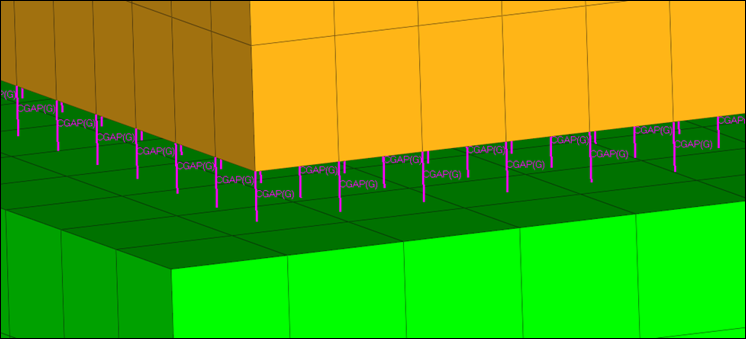

contact_cgap
Note:
  1. For small displacement analysis, N2S contact elements are created with CGAPG as the core.
  2. For Large displacement analysis, N2S contact elements consist of non-CGAPG cores.
  3. Each N2S contact element consists of a secondary node, a few main nodes, and one main face.

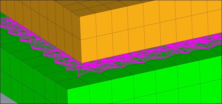

contact_gap
CONTPRM,CONTOUT,YES can be used to visualize S2S contact elements (and large-displacement N2S contact elements) as PLOTEL+RBE3 elements. The *.contout.fem file contains the elements for visualization only.

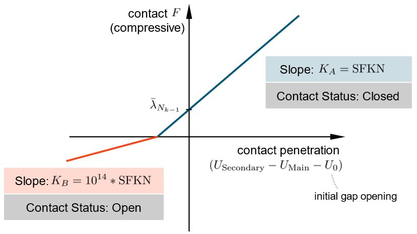

The stiffness of each contact element typically depends on the type of analysis, linear or nonlinear, that is performed. For Linear Analysis, the contact stiffness is constant throughout the solution. The contact stiffness depends on the initial state of the contact. If the contact is initially open, it remains open for the duration of the run. The same goes for closed contacts. The contact status or the contact stiffness values are not updated during the course of the solution for linear runs. The initial contact stiffness of each contact element depends on the initial contact gap opening distance (U0), which is calculated based on the positions of the Secondary and Main (including contributions from the GPAD field, if any). For open contact elements, a very small stiffness value of KB=10-14 * STIFF is used to avoid numerical singularities.
Figure 8. Penalty-based Contact Element Force-Displacement Curves for Linear Analysis
Linear Penalty Curve (Nonlinear Analysis)
For Nonlinear Analysis, the contact status can change during the run, which implies that the contact element stiffness can switch between the closed (KA) and open (KB) values.
For Nonlinear Analysis, the contact condition does not change within an iteration, during reevaluation at the end of each iteration, if the contact condition for some or all contact elements has changed, the revised contact condition is used for the subsequent iteration. Therefore, over the course of a Nonlinear Analysis the contact can open or close multiple times. The contact stiffness is KA when closed and KB when open, similar to the linear case; however, since the contact status can change, the contact element force is not tensile, with slope KA, when the contact moves from closed to open status. When the contact is open, the normal stiffness is essentially zero (very small slope KB to avoid singularities). The closure of the contact element increases the stiffness value to KA.
Figure 9. Penalty-based Contact Element Force-Displacement Curves for Nonlinear Analysis

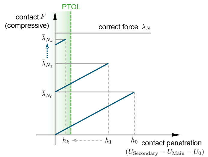

Augmented Lagrange Multiplier (ALM) Method (Nonlinear Analysis)
The ALM method does not introduce real Lagrange multipliers as additional unknown variables in the system and can instead be categorized as a variant of the penalty-based method. When the ALM method is activated, the contact pressure data in the last converged results are employed as constant multipliers in the pressure formulation of the succeeding iterations, as shown in the force-penetration curve in Figure 12, where λ ̅_(N k-1) is the normal force obtained from the last converged state. The ALM method uses the contact pressure to determine the open/close status of a contact element.
The ALM method is applicable to Nonlinear Static and Transient Analysis and can be activated by CONTPRM,ALM,YES or the ALM continuation line on the PCONT Bulk Data Entry. Additional augmentations iterations are carried out when a time increment is converged while the penetration tolerance, defined with CONTPRM,ALMPTOL or the PTOL field on the PCONT Bulk Data Entry, is not satisfied.
The schematic augmentation process of the contact force is visualized in Figure 13 where the contact force approaches the correct value after a few augmentations, with the subscript k (k=0, 1, …) denoting the augmentation index. Usually, the default tolerance is recommended such that a balance between accuracy and computational cost is achieved. Pressure augmentation also happens naturally at new time increments without direct augmentation iterations and setting the tolerance too strict may result in excessive number of augmentation iterations.
The ALM method can achieve an accurate result on the contact interface with relatively soft penalty stiffness, though it may result in an increased number of iterations in some cases. The penalty stiffness for the ALM method is controlled by CONTPRM,ALMSFKN or the SFKN field on the PCONT Bulk Data Entry, and is independent of any STIFF options mentioned in the preceding sections. Option SFKN=AUTO determines the value of the normal penalty stiffness for each contact element using the stiffness of surrounding elements along the normal direction of the surface. Generally, the AUTO stiffness for the ALM method is softer than the AUTO stiffness employed in the penalty-based contact. Additional options AUTO, HARD, SOFT or Real<0.0 for SFKN are available as a scaling factor applied on the stiffness value via SFKN=AUTO.

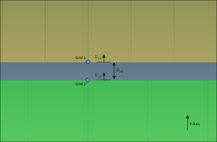

The MPC equation can be setup by monitoring the relative displacement of the grids in contact in the direction perpendicular to the contact interface. The initial contact gap is also factored into the equation setup.
Figure 20.
contact_mpc2
MPC Equation
u 12 R = u 12 I G + u 1 Y u 2 Y
or
u 12 R u 12 I G u 1 Y + u 2 Y = 0
Where,
u 12 R
Relative displacement between grid points 1 and 2 along the Y-Axis
u 12 I G
Initial contact gap between the grid points 1 and 2 along the Y-Axis
u 1 Y
Displacement of grid point 1 in the positive Y-Axis
u 2 Y
Displacement of grid point 2 in the positive Y-Axis
Since u 12 R and u 12 I G are not inherently available in the model, SPOINT's are created to represent these quantities. u 12 I G is related to an SPC Bulk Data Entry via the SPOINT ID and the value of the initial contact gap is set on the D field on the SPC entry. u 12 R is related to a SUPORT Bulk Data Entry via the SPOINT ID. PARAM,CDPCH can be used to control the printing of the final state of DMIG,CDSHUT after Fast Contact Analysis. PARAM,CDPRT can be used to control the printing of violations in intermediate iterations in Fast Contact Analysis.
Example: Input Deck
The following input deck illustrates the setup of a model with grid points 1 and 2 at an initial contact gap of 2.35.
