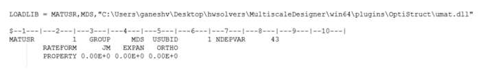

The MATUSR Bulk Data Entry, in combination with the LOADLIB I/O Option Entry, allows for the definition of structural material through user-defined external functions.
The external functions may be written in Fortran, C or C++. The resulting libraries and files should be accessible by OptiStruct regardless of the coding language, provided that consistent function prototyping is respected, and adequate compiling and linking options are used.

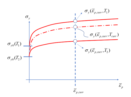

Temperature-dependent combined hardening
If temperature-dependent combined hardening is active, then all the parameters are temperature dependent, for example,
C k ( T ) γ k ( T ) σ y 0 ( T ) Q ( T ) b ( T ) MathType@MTEF@5@5@+= feaagKart1ev2aaatCvAUfeBSjuyZL2yd9gzLbvyNv2CaerbuLwBLn hiov2DGi1BTfMBaeXatLxBI9gBaerbd9wDYLwzYbItLDharqqtubsr 4rNCHbGeaGqiVu0Je9sqqrpepC0xbbL8F4rqqrFfpeea0xe9Lq=Jc9 vqaqpepm0xbba9pwe9Q8fs0=yqaqpepae9pg0FirpepeKkFr0xfr=x fr=xb9adbaqaaeGaciGaaiaabeqaamaabaabaaGceaqabeaacaWGdb WaaSbaaSqaaiaadUgaaeqaaOGaaiikaiaadsfacaGGPaaabaGaeq4S dC2aaSbaaSqaaiaadUgaaeqaaOGaaiikaiaadsfacaGGPaaabaGaeq 4Wdm3aaSbaaSqaaiaadMhacaaIWaaabeaakiaacIcacaWGubGaaiyk aaqaaiaadgfacaGGOaGaamivaiaacMcaaeaacaWGIbGaaiikaiaads facaGGPaaaaaa@4B23@
From experiment is only possible to test a limited number of temperatures. Interpolation is used to solving for plasticity at a temperature in between the test temperatures.
Using isotropic hardening NLISO as an example, if the parameters are provided at two temperatures T 1 MathType@MTEF@5@5@+= feaagKart1ev2aaatCvAUfeBSjuyZL2yd9gzLbvyNv2CaerbuLwBLn hiov2DGi1BTfMBaeXatLxBI9gBaerbd9wDYLwzYbItLDharqqtubsr 4rNCHbGeaGqiVu0Je9sqqrpepC0xbbL8F4rqqrFfpeea0xe9Lq=Jc9 vqaqpepm0xbba9pwe9Q8fs0=yqaqpepae9pg0FirpepeKkFr0xfr=x fr=xb9adbaqaaeGaciGaaiaabeqaamaabaabaaGcbaGaamivamaaBa aaleaacaaIXaaabeaaaaa@37B6@ and T 2 MathType@MTEF@5@5@+= feaagKart1ev2aaatCvAUfeBSjuyZL2yd9gzLbvyNv2CaerbuLwBLn hiov2DGi1BTfMBaeXatLxBI9gBaerbd9wDYLwzYbItLDharqqtubsr 4rNCHbGeaGqiVu0Je9sqqrpepC0xbbL8F4rqqrFfpeea0xe9Lq=Jc9 vqaqpepm0xbba9pwe9Q8fs0=yqaqpepae9pg0FirpepeKkFr0xfr=x fr=xb9adbaqaaeGaciGaaiaabeqaamaabaabaaGcbaGaamivamaaBa aaleaacaaIXaaabeaaaaa@37B6@ , then there are two yield stress functions for interpolation:
σ y ( ε ¯ p , T 1 ) = σ y 0 + Q ( T 1 ) ( 1 e b ( T 1 ) ε ¯ p ) MathType@MTEF@5@5@+= feaagKart1ev2aaatCvAUfeBSjuyZL2yd9gzLbvyNv2CaerbuLwBLn hiov2DGi1BTfMBaeXatLxBI9gBaerbd9wDYLwzYbItLDharqqtubsr 4rNCHbGeaGqiVu0Je9sqqrpepC0xbbL8F4rqqrFfpeea0xe9Lq=Jc9 vqaqpepm0xbba9pwe9Q8fs0=yqaqpepae9pg0FirpepeKkFr0xfr=x fr=xb9adbaqaaeGaciGaaiaabeqaamaabaabaaGcbaGaeq4Wdm3aaS baaSqaaiaadMhaaeqaaOGaaiikaiqbew7aLzaaraWaaSbaaSqaaiaa dchaaeqaaOGaaiilaiaadsfadaWgaaWcbaGaaGymaaqabaGccaGGPa Gaeyypa0Jaeq4Wdm3aaSbaaSqaaiaadMhacaaIWaaabeaakiabgUca RiaadgfacaGGOaGaamivamaaBaaaleaacaaIXaaabeaakiaacMcacq GHflY1caGGOaGaaGymaiabgkHiTiaadwgadaahaaWcbeqaaiabgkHi TiaadkgacaGGOaGaamivamaaBaaameaacaaIXaaabeaaliaacMcacq GHflY1cuaH1oqzgaqeamaaBaaameaacaWGWbaabeaaaaGccaGGPaaa aa@59CC@
σ y ( ε ¯ p , T 2 ) = σ y 0 + Q ( T 2 ) ( 1 e b ( T 2 ) ε ¯ p ) MathType@MTEF@5@5@+= feaagKart1ev2aaatCvAUfeBSjuyZL2yd9gzLbvyNv2CaerbuLwBLn hiov2DGi1BTfMBaeXatLxBI9gBaerbd9wDYLwzYbItLDharqqtubsr 4rNCHbGeaGqiVu0Je9sqqrpepC0xbbL8F4rqqrFfpeea0xe9Lq=Jc9 vqaqpepm0xbba9pwe9Q8fs0=yqaqpepae9pg0FirpepeKkFr0xfr=x fr=xb9adbaqaaeGaciGaaiaabeqaamaabaabaaGcbaGaeq4Wdm3aaS baaSqaaiaadMhaaeqaaOGaaiikaiqbew7aLzaaraWaaSbaaSqaaiaa dchaaeqaaOGaaiilaiaadsfadaWgaaWcbaGaaGOmaaqabaGccaGGPa Gaeyypa0Jaeq4Wdm3aaSbaaSqaaiaadMhacaaIWaaabeaakiabgUca RiaadgfacaGGOaGaamivamaaBaaaleaacaaIYaaabeaakiaacMcacq GHflY1caGGOaGaaGymaiabgkHiTiaadwgadaahaaWcbeqaaiabgkHi TiaadkgacaGGOaGaamivamaaBaaameaacaaIYaaabeaaliaacMcacq GHflY1cuaH1oqzgaqeamaaBaaameaacaWGWbaabeaaaaGccaGGPaaa aa@59CF@
The interpolated yield stress at the current temperature T c u r r MathType@MTEF@5@5@+= feaagKart1ev2aaatCvAUfeBSjuyZL2yd9gzLbvyNv2CaerbuLwBLn hiov2DGi1BTfMBaeXatLxBI9gBaerbd9wDYLwzYbItLDharqqtubsr 4rNCHbGeaGqiVu0Je9sqqrpepC0xbbL8F4rqqrFfpeea0xe9Lq=Jc9 vqaqpepm0xbba9pwe9Q8fs0=yqaqpepae9pg0FirpepeKkFr0xfr=x fr=xb9adbaqaaeGaciGaaiaabeqaamaabaabaaGcbaGaamivamaaBa aaleaacaWGJbGaamyDaiaadkhacaWGYbaabeaaaaa@3ACB@ in [ T 1 MathType@MTEF@5@5@+= feaagKart1ev2aaatCvAUfeBSjuyZL2yd9gzLbvyNv2CaerbuLwBLn hiov2DGi1BTfMBaeXatLxBI9gBaerbd9wDYLwzYbItLDharqqtubsr 4rNCHbGeaGqiVu0Je9sqqrpepC0xbbL8F4rqqrFfpeea0xe9Lq=Jc9 vqaqpepm0xbba9pwe9Q8fs0=yqaqpepae9pg0FirpepeKkFr0xfr=x fr=xb9adbaqaaeGaciGaaiaabeqaamaabaabaaGcbaGaamivamaaBa aaleaacaaIXaaabeaaaaa@37B6@ , T 2 MathType@MTEF@5@5@+= feaagKart1ev2aaatCvAUfeBSjuyZL2yd9gzLbvyNv2CaerbuLwBLn hiov2DGi1BTfMBaeXatLxBI9gBaerbd9wDYLwzYbItLDharqqtubsr 4rNCHbGeaGqiVu0Je9sqqrpepC0xbbL8F4rqqrFfpeea0xe9Lq=Jc9 vqaqpepm0xbba9pwe9Q8fs0=yqaqpepae9pg0FirpepeKkFr0xfr=x fr=xb9adbaqaaeGaciGaaiaabeqaamaabaabaaGcbaGaamivamaaBa aaleaacaaIXaaabeaaaaa@37B6@ ] is then,
σ y ( ε ¯ p , T c u r r ) = f 1 σ y ( ε ¯ p , T 1 ) + f 2 σ y ( ε ¯ p , T 2 ) MathType@MTEF@5@5@+= feaagKart1ev2aaatCvAUfeBSjuyZL2yd9gzLbvyNv2CaerbuLwBLn hiov2DGi1BTfMBaeXatLxBI9gBaerbd9wDYLwzYbItLDharqqtubsr 4rNCHbGeaGqiVu0Je9sqqrpepC0xbbL8F4rqqrFfpeea0xe9Lq=Jc9 vqaqpepm0xbba9pwe9Q8fs0=yqaqpepae9pg0FirpepeKkFr0xfr=x fr=xb9adbaqaaeGaciGaaiaabeqaamaabaabaaGcbaGaeq4Wdm3aaS baaSqaaiaadMhaaeqaaOGaaiikaiqbew7aLzaaraWaaSbaaSqaaiaa dchaaeqaaOGaaiilaiaadsfadaWgaaWcbaGaam4yaiaadwhacaWGYb GaamOCaaqabaGccaGGPaGaeyypa0JaamOzamaaBaaaleaacaaIXaaa beaakiabgwSixlabeo8aZnaaBaaaleaacaWG5baabeaakiaacIcacu aH1oqzgaqeamaaBaaaleaacaWGWbaabeaakiaacYcacaWGubWaaSba aSqaaiaaigdaaeqaaOGaaiykaiabgUcaRiaadAgadaWgaaWcbaGaaG OmaaqabaGccqGHflY1cqaHdpWCdaWgaaWcbaGaamyEaaqabaGccaGG OaGafqyTduMbaebadaWgaaWcbaGaamiCaaqabaGccaGGSaGaamivam aaBaaaleaacaaIYaaabeaakiaacMcaaaa@605D@
with two factors for different temperatures f 1 = T 2 T c u r r T 2 T 1 MathType@MTEF@5@5@+= feaagKart1ev2aaatCvAUfeBSjuyZL2yd9gzLbvyNv2CaerbuLwBLn hiov2DGi1BTfMBaeXatLxBI9gBaerbd9wDYLwzYbItLDharqqtubsr 4rNCHbGeaGqiVu0Je9sqqrpepC0xbbL8F4rqqrFfpeea0xe9Lq=Jc9 vqaqpepm0xbba9pwe9Q8fs0=yqaqpepae9pg0FirpepeKkFr0xfr=x fr=xb9adbaqaaeGaciGaaiaabeqaamaabaabaaGcbaGaamOzamaaBa aaleaacaaIXaaabeaakiabg2da9maalaaabaGaamivamaaBaaaleaa caaIYaaabeaakiabgkHiTiaadsfaqaaaaaaaaaWdbmaaBaaaleaaca WGJbGaamyDaiaadkhacaWGYbaabeaaaOWdaeaacaWGubWaaSbaaSqa aiaaikdaaeqaaOGaeyOeI0IaamivamaaBaaaleaacaaIXaaabeaaaa aaaa@4526@ , f 2 = T c u r r T 1 T 2 T 1 MathType@MTEF@5@5@+= feaagKart1ev2aaatCvAUfeBSjuyZL2yd9gzLbvyNv2CaerbuLwBLn hiov2DGi1BTfMBaeXatLxBI9gBaerbd9wDYLwzYbItLDharqqtubsr 4rNCHbGeaGqiVu0Je9sqqrpepC0xbbL8F4rqqrFfpeea0xe9Lq=Jc9 vqaqpepm0xbba9pwe9Q8fs0=yqaqpepae9pg0FirpepeKkFr0xfr=x fr=xb9adbaqaaeGaciGaaiaabeqaamaabaabaaGcbaGaamOzamaaBa aaleaacaaIYaaabeaakiabg2da9maalaaabaGaamivaabaaaaaaaaa peWaaSbaaSqaaiaadogacaWG1bGaamOCaiaadkhaaeqaaOWdaiabgk HiTiaadsfadaWgaaWcbaGaaGymaaqabaaakeaacaWGubWaaSbaaSqa aiaaikdaaeqaaOGaeyOeI0IaamivamaaBaaaleaacaaIXaaabeaaaa aaaa@4526@ .
As an example, Figure 2 illustrates the principle of interpolation.
It is worthy to mention that the parameters (Q and B) are not interpolated directly. Instead, the yield functions at two temperatures are interpolated. This is the similar case for NLKIN, where the evolution laws at two temperatures are interpolated.
Figure 2. Principle of interpolation for temperature dependent NLISO

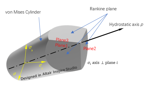

In the principal stress space, the yield function is a von Mises cylinder intersected with Rankine planes (Figure 3). The yield surface is illustrated in π MathType@MTEF@5@5@+= feaagKart1ev2aaatCvAUfeBSjuyZL2yd9gzLbvyNv2CaerbuLwBLn hiov2DGi1BTfMBaeXatLxBI9gBaerbd9wDYLwzYbItLDharqqtubsr 4rNCHbGeaGqiVu0Je9sqqrpepC0xbbL8F4rqqrFfpeea0xe9Lq=Jc9 vqaqpepm0xbba9pwe9Q8fs0=yqaqpepae9pg0FirpepeKkFr0xfr=x fr=xb9adbaqaaeGaciGaaiaabeqaamaabaabaaGcbaGaeqiWdahaaa@37B3@ plane in Figure 4 and Figure 5, and in meridional plane in Figure 6.
r = ( 9 2 S S : S ) MathType@MTEF@5@5@+= feaagKart1ev2aqatCvAUfeBSjuyZL2yd9gzLbvyNv2CaerbuLwBLn hiov2DGi1BTfMBaeXatLxBI9gBaerbd9wDYLwzYbItLDharqqtubsr 4rNCHbGeaGqiVu0Je9sqqrpepC0xbbL8F4rqqrFfpeea0xe9Lq=Jc9 vqaqpepm0xbba9pwe9Q8fs0=yqaqpepae9pg0FirpepeKkFr0xfr=x fr=xb9adbaqaaeGaciGaaiaabeqaamaabaabaaGcbaGaamOCaiabg2 da9maabmaabaWaaSaaaeaacaaI5aaabaGaaGOmaaaacaWHtbGaeyyX ICTaaC4uaiaacQdacaWHtbaacaGLOaGaayzkaaaaaa@40A8@
Where, S MathType@MTEF@5@5@+= feaagKart1ev2aqatCvAUfeBSjuyZL2yd9gzLbvyNv2CaerbuLwBLn hiov2DGi1BTfMBaeXatLxBI9gBaerbd9wDYLwzYbItLDharqqtubsr 4rNCHbGeaGqiVu0Je9sqqrpepC0xbbL8F4rqqrFfpeea0xe9Lq=Jc9 vqaqpepm0xbba9pwe9Q8fs0=yqaqpepae9pg0FirpepeKkFr0xfr=x fr=xb9adbaqaaeGaciGaaiaabeqaamaabaabaaGcbaGaaC4uaaaa@36D3@ is the tensor form of deviatoric stress.
Yield Surface of cast iron plasticity.
Figure 3. Overview on the yield surface
Figure 4. σ1-σ2 plane view
Figure 5. A-A view on the π plane
Figure 6. Meridional plane view

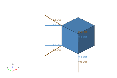

The user material is simulated in OptiStruct with nonlinear quasi-static analysis of a unit CHEXA cube element connected to eight CELAS1 spring elements (Figure 8). The springs have very low stiffness and are fixed on one end. Four springs have a connection in the y-direction and four have connections in the z-direction. The springs ensure that there are no rigid body motions in y- and z-directions. The unit CHEXA cube element is constrained along the x-translation direction; x, y and z rotational directions on the side which is connected to the springs and on the other side, the element is subjected to contraction load = 0.009 mm and extension load =0.007 mm in subcase 1 and 2, respectively.

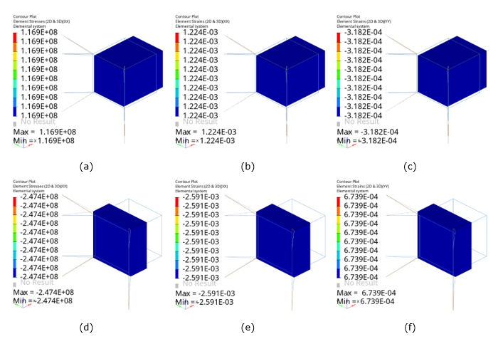

Figure 8. Unit CHEXA Cube Element Model Connected to Springs

    The generated plugin data file (OptiStruct_plugin_data.fem) contains the LOADLIB I/O and MATUSR cards for running the structural analysis. The LOADLIB I/O Entry is used to implement external subroutines and MATUSR is used to defined user material parameters and properties. These cards are later inserted into OptiStruct input model files (*.fem).
    Note:
    1. The input model file should be in the same folder as the multiscale material. The material subroutines are called into this database through LOADLIB.
    2. The USUBID number in the MATUSR should refer to the multiscale material model ID.

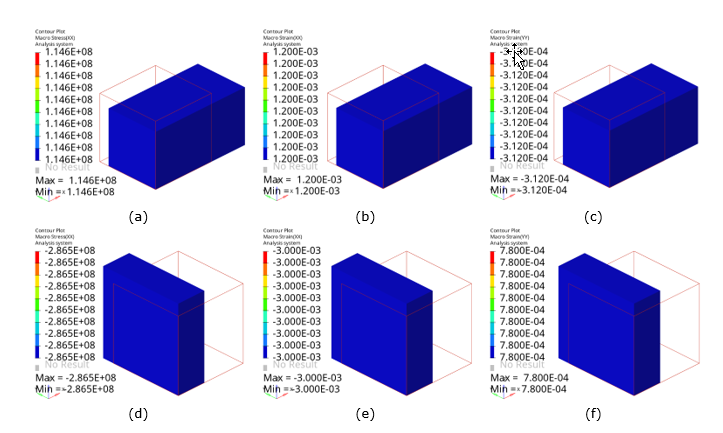

Figure 9. Built-in Macro Simulation in Multiscale Designer (Contour Plots). (a) and (d) x-direction stress in tension and compression, respectively; (b) and (e) x-direction strains in tension and compression, respectively; and (c) and (f) y-direction strains in tension and compression, respectively
The calculated homogenized parameter properties and values are:

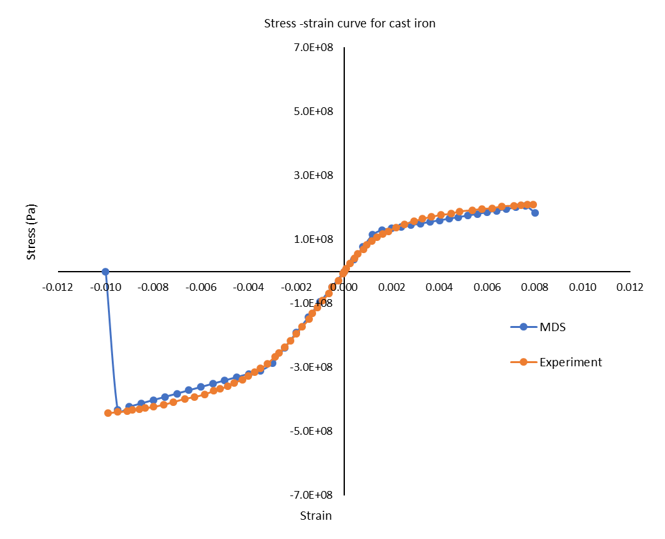

The stress-strain curve generated from Multiscale Designer is shown in Figure 10. The maximum difference between Multiscale Designer and experiment is 9.6 % at 0.004 strain. At strain values of -0.01 and 0.008, the models are fully damaged; therefore, it is recommended to use the material with a strain value from -0.095 to 0.0076. The stresses corresponding to the fully damaged strains are -0.96 MPa and 184.13 MPa, respectively. The results are plotted against data from experiments 11 and Multiscale Designer.
Figure 10. Stress-Strain Curve of Cast Iron from Multiscale Designer and Experiment

Structural Analysis
NLPARM and NLOUT cards are used for solution control and incremental solution output, respectively, for nonlinear analysis in OptiStruct. In this model, the incremental results are output for each load increment value of 0.05. The material stays linear up to a load factor of 0.175 for tension and 0.2875 for compression. Figure 12 shows the contour plots of x-direction stresses, x-direction strains and y-direction strains for the corresponding load factors. The wireframes in Figure 12 shows the undeformed boundaries.
Figure 12. Structural Analysis in OptiStruct (Contour Plots). (a) and (d) x-direction stress in tension and compression, respectively; (b) and (e) x-direction strains in tension and compression, respectively; and (c) and (f) y-direction strains in tension and compression, respectively

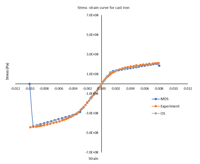

Figure 13 depicts the stress-strain curve generated from OptiStruct using MATUSR and LOADLIB. The plot shows that the user-material from Multiscale Designer can be simulated well in OptiStruct.
Figure 13. Stress-Strain Curve of Cast Iron

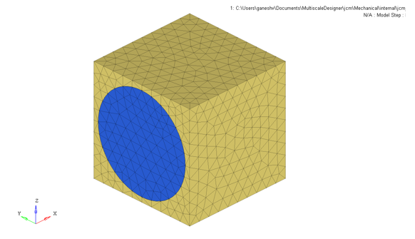

Figure 15 represents the square fiber packing array generated from Multiscale Designer. The relative radius of the fiber with respect to the unit cell size for the fiber volume fraction is 0.45.
Figure 15. Unit Cell Model of Square Packing Array . with Fiber Volume Fraction = 65%

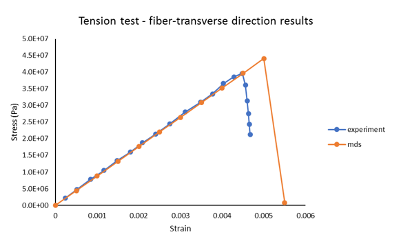

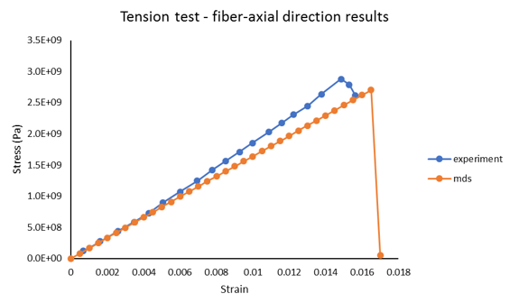

Figure 16 and Figure 17 show the stress-strain curve generated from Multiscale Designer for fiber-axial and fiber-transverse direction tensile tests. These values are plotted over experimental data. 13 The maximum difference in tensile yield strength between Multiscale Designer and experiment is 6.0 % for the fiber-axial direction test and 11.3 % for the fiber-transverse direction test.
Figure 16. Comparison of Stress-Strain Curves. fiber-axial tensile test from Multiscale Designer and experiment
Figure 17. Stress-Strain Curve. fiber-transverse tensile test from Multiscale Designer and experiment

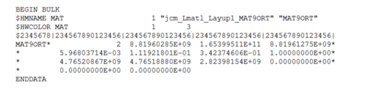

A MAT9ORT material file generated from Multiscale Designer is illustrated in Figure 18. These files are to be used in OptiStruct to run any structural analysis. The OptiStruct plugin file which contains the LOADLIB I/O and MATUSR cards is the same as in Figure 11.
Figure 18. Homogenized Composite Properties in OptiStruct MAT9ORT Format
