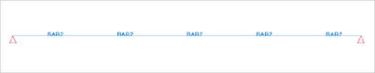

The 2-node beam elements are used to model the simply-supported beam which consists of five elements. The displacements in x, y, and z direction, as well as the rotation in x direction are fixed at the end A. In addition, the displacements in y and z direction are constrained at end B.
