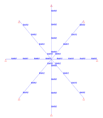

The 2-node simple beam elements are used to model the double cross. Each arm of the cross consists of four elements. The x- and y-translation displacements are fixed at the end of all arms.
