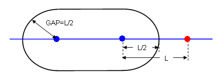

Figure 1
illustrates a self-impacting interface for which the GAP equals
half the side length of an element. If this element is compressed more than 50%, the
red node enters into the gap of the neighboring element; a self-contact is then
detected which should not be the case. This leads to over-stiffening of the
structure.
Figure 1. Recommended Gap When Modeling Auto-Contact
If the side length, L of an element is lower than the GAP,
a self-contact will even be computed from the beginning of the computation.
