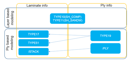

Modeling composites in Radioss may be defined as Layer-based or Ply-based with different properties.
  • Layer-based modeling with /PROP/TYPE10 (SH_COMP), /PROP/TYPE11 (SH_SANDW)
  • Ply-based modeling with /PROP/TYPE17 (STACK), /PROP/TYPE51, /PROP/PCOMPP+/STACK, /PROP/TYPE19 (PLY) and /PLY
For ply-based modeling, info (like material, thickness, anisotropic angle, anisotropic axis angle and number of integration points) for each ply defined in /PROP/TYPE19 (or /PLY) and assembled in /PROP/TYPE17 or /PROP/TYPE51 (or /STACK) with option Pply_IDi.

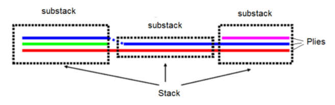

For ply-based modeling, plies may be assembled "by ply” or “by substack”. “By ply” is simply the order of the plies one by one from bottom to top. “By substack” uses a series of ordered plies one by one to create each substack, and then each substack may be combined with substack connection “INT”.
Figure 3.

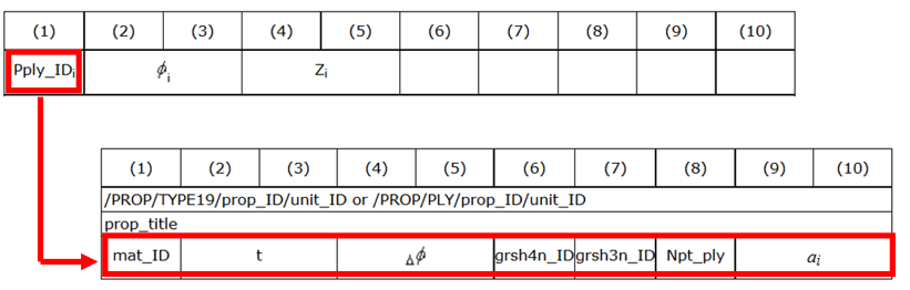

Figure 4. Stack in /PROP/TYPE51

For ply-based modeling, which use /PROP/TYPE17, /TYPE51 or /STACK/PCOMPP. Pply_IDi is the number of plies through the shell thickness. Plies could be combined until n plies for these properties.
For TYPE17 only one integration point is allowed while for TYPE51 and /STACKF up to 9 integration points are allowed. The number of integration points are defined with option “Npt_ply” in property TYPE19 or /PLY.

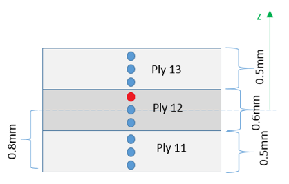

Example (Ply) (/PROP/TYPE51)
In this example, Npt_ply=3 defined in /PROP/TYPE19, means 3 integration points are defined per ply and with option Iint=0 is defined in /PROP/TYPE51, then these 3 integration points are uniformly distributed through each ply thickness.
Figure 5.
If Iint=1 in /PROP/TYPE51, the integration points are distributed following Forces and Moments Calculation Gauss Integration Scheme through each ply thickness.
Figure 6.

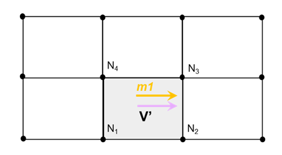

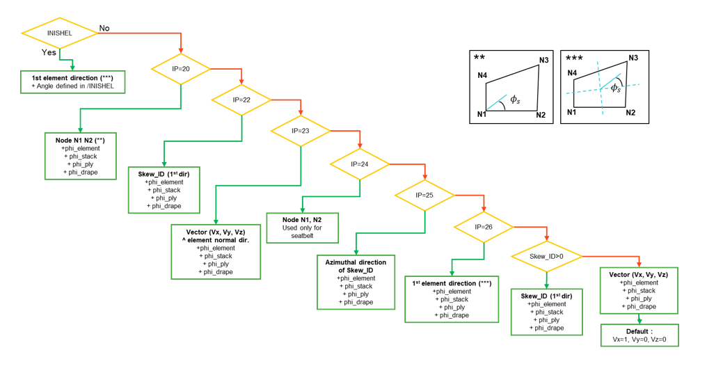

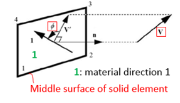

  • The reference vector for the first anisotropic direction of the material may be defined with the flag IP, local coordinate system skew_ID or vector (Vx, Vy, Vz)
    IP=0, skew_ID=0 Vector (Vx, Vy, Vz)
    IP=0, skew_ID≠0 First direction (local X) of the local coordinate system skew_ID.
    IP=20 node N1 and N2 of the shell elements
    IP=22 First direction (local X) of the local coordinate system skew_ID.
    IP=23 Product of vector (Vx, Vy, Vz) and the shell element normal direction n
    IP=24 (for seatbelt element only) Shell seatbelt (only for /MAT/LAW119) width direction from 1st direction of skew_ID or with the node N1 and N2 of the shell elements.
    skew_ID=0:
    skew_ID≠0:
    IP=25 Azimuthal direction defined with local cylindrical coordinate system skew_ID (2nd direction).

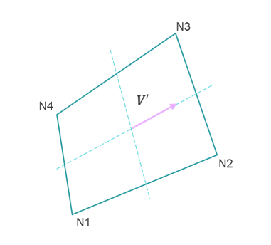

    IP=26 First axis of the element coordinate system
  • The first material direction is defined from the reference vector and the anisotropy angles defined as:

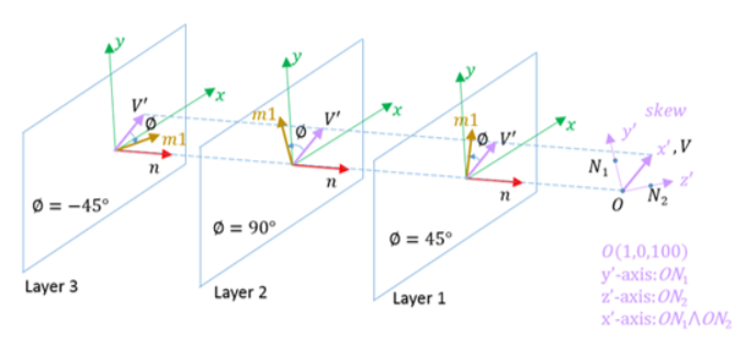

    Figure 8 shows an Example in /PROP/TYPE11 which uses skew to define global vector V MathType@MTEF@5@5@+= feaagKart1ev2aaatCvAUfeBSjuyZL2yd9gzLbvyNv2CaerbuLwBLn hiov2DGi1BTfMBaeXatLxBI9gBaerbd9wDYLwzYbItLDharqqtubsr 4rNCHbGeaGqiVu0Je9sqqrpepC0xbbL8F4rqqrFfpeea0xe9Lq=Jc9 vqaqpepm0xbba9pwe9Q8fs0=yqaqpepae9pg0FirpepeKkFr0xfr=x fr=xb9adbaqaaeGaciGaaiaabeqaamaabaabaaGcbaGaaCOvaaaa@36D5@ .
    Figure 8.

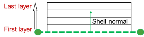

  • For /PROP/TYPE10, layer thickness is simply averaged by layer number
    t i = T h i c k / N MathType@MTEF@5@5@+= feaagKart1ev2aqatCvAUfeBSjuyZL2yd9gzLbvyNv2CaerbuLwBLn hiov2DGi1BTfMBaeXatLxBI9gBaerbd9wDYLwzYbItLDharqqtubsr 4rNCHbGeaGqiVu0Je9sqqrpepC0xbbL8F4rqqrFfpeea0xe9Lq=Jc9 vqaqpepm0xbba9pwe9Q8fs0=yqaqpepae9pg0FirpepeKkFr0xfr=x fr=xb9adbaqaaeGaciGaaiaabeqaamaabaabaaGcbaGaamiDamaaBa aaleaacaWGPbaabeaakiabg2da9iaadsfacaWGObGaamyAaiaadoga caWGRbGaai4laiaad6eaaaa@3F2C@
    and layers are automatically stacked one by one from bottom to top.
    Figure 10.

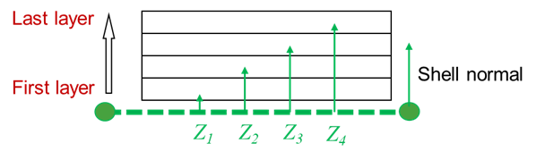

  • For properties TYPE11, TYPE17, TYPE51 and /STACK, layer (ply) position and thickness depend on option Ipos
    • If Ipos=0
      User layer (ply) thickness input t i MathType@MTEF@5@5@+= feaagKart1ev2aqatCvAUfeBSjuyZL2yd9gzLbvyNv2CaerbuLwBLn hiov2DGi1BTfMBaeXatLxBI9gBaerbd9wDYLwzYbItLDharqqtubsr 4rNCHbGeaGqiVu0Je9sqqrpepC0xbbL8F4rqqrFfpeea0xe9Lq=Jc9 vqaqpepm0xbba9pwe9Q8fs0=yqaqpepae9pg0FirpepeKkFr0xfr=x fr=xb9adbaqaaeGaciGaaiaabeqaamaabaabaaGcbaGaamiDamaaBa aaleaacaWGPbaabeaaaaa@380A@ will be taken, and layer (ply) position will be automatically calculated one by one from bottom to top; but if,
      ∑ i t i ≠ T h i c k MathType@MTEF@5@5@+= feaagKart1ev2aqatCvAUfeBSjuyZL2yd9gzLbvyNv2CaerbuLwBLn hiov2DGi1BTfMBaeXatLxBI9gBaerbd9wDYLwzYbItLDharqqtubsr 4rNCHbGeaGqiVu0Je9sqqrpepC0xbbL8F4rqqrFfpeea0xe9Lq=Jc9 vqaqpepm0xbba9pwe9Q8fs0=yqaqpepae9pg0FirpepeKkFr0xfr=x fr=xb9adbaqaaeGaciGaaiaabeqaamaabaabaaGcbaWaaabuaeaaca WG0bWaaSbaaSqaaiaadMgaaeqaaaqaaiaadMgaaeqaniabggHiLdGc cqGHGjsUcaWGubGaamiAaiaadMgacaWGJbGaam4Aaaaa@416D@
      Then, layer (ply) thickness will be adjusted to t i n e w MathType@MTEF@5@5@+= feaagKart1ev2aqatCvAUfeBSjuyZL2yd9gzLbvyNv2CaerbuLwBLn hiov2DGi1BTfMBaeXatLxBI9gBaerbd9wDYLwzYbItLDharqqtubsr 4rNCHbGeaGqiVu0Je9sqqrpepC0xbbL8F4rqqrFfpeea0xe9Lq=Jc9 vqaqpepm0xbba9pwe9Q8fs0=yqaqpepae9pg0FirpepeKkFr0xfr=x fr=xb9adbaqaaeGaciGaaiaabeqaamaabaabaaGcbaGaamiDamaaDa aaleaacaWGPbaabaGaamOBaiaadwgacaWG3baaaaaa@3AE4@ , so that
      ∑ i t i n e w = T h i c k MathType@MTEF@5@5@+= feaagKart1ev2aqatCvAUfeBSjuyZL2yd9gzLbvyNv2CaerbuLwBLn hiov2DGi1BTfMBaeXatLxBI9gBaerbd9wDYLwzYbItLDharqqtubsr 4rNCHbGeaGqiVu0Je9sqqrpepC0xbbL8F4rqqrFfpeea0xe9Lq=Jc9 vqaqpepm0xbba9pwe9Q8fs0=yqaqpepae9pg0FirpepeKkFr0xfr=x fr=xb9adbaqaaeGaciGaaiaabeqaamaabaabaaGcbaWaaabuaeaaca WG0bWaa0baaSqaaiaadMgaaeaacaWGUbGaamyzaiaadEhaaaaabaGa amyAaaqab0GaeyyeIuoakiabg2da9iaadsfacaWGObGaamyAaiaado gacaWGRbaaaa@4386@
      Layer (ply) position will be then adjusted, as well (Figure 10).

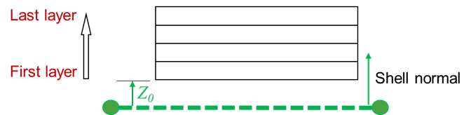

  • For properties TYPE17, TYPE51 and /STACK, it is also possible to offset the plies with Ipos=2, 3, 4
    • Ipos=2: the bottom of the ply layout is at Z0 from element mid-surface.
      Figure 12.

  • Anisotrophy in Layer (Ply)
    Similar to shell property /PROP/TYPE11, reference vector V MathType@MTEF@5@5@+= feaagKart1ev2aaatCvAUfeBSjuyZL2yd9gzLbvyNv2CaerbuLwBLn hiov2DGi1BTfMBaeXatLxBI9gBaerbd9wDYLwzYbItLDharqqtubsr 4rNCHbGeaGqiVu0Je9sqqrpepC0xbbL8F4rqqrFfpeea0xe9Lq=Jc9 vqaqpepm0xbba9pwe9Q8fs0=yqaqpepae9pg0FirpepeKkFr0xfr=x fr=xb9adbaqaaeGaciGaaiaabeqaamaabaabaaGcbaGaaCOvaaaa@36D5@ and angle ϕ are used to define the material direction 1. The reference vector V MathType@MTEF@5@5@+= feaagKart1ev2aaatCvAUfeBSjuyZL2yd9gzLbvyNv2CaerbuLwBLn hiov2DGi1BTfMBaeXatLxBI9gBaerbd9wDYLwzYbItLDharqqtubsr 4rNCHbGeaGqiVu0Je9sqqrpepC0xbbL8F4rqqrFfpeea0xe9Lq=Jc9 vqaqpepm0xbba9pwe9Q8fs0=yqaqpepae9pg0FirpepeKkFr0xfr=x fr=xb9adbaqaaeGaciGaaiaabeqaamaabaabaaGcbaGaaCOvaaaa@36D5@ project to the middle surface of solid element and turn ϕ degree is the material direction 1.
    Figure 17.
