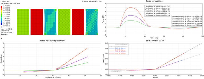

As the results are similar between both Ishell = 24 and Ishell = 12 for shell elements only Ishell = 24 results are represented below.
The stress versus strain output from the time history with stiffness defined in the material both in tensile and compression.
Figure 2. Tensile and compression results
The reaction force measured at the anchorage point (through rigid body) is equal to the strain * Elastic modulus * coupon section (area) and is very close to the theoretical value.
Tensile 0 degrees = 3kN
elongation (20) / initial length (320) * E11 (0.3) * width (160) * thickness (1)
Tensile 90 degrees = 5kN
elongation (20) / initial length (320) * E22 (0.5) * width (160) * thickness (1)
Compression 0 degrees = 0.3kN
RE (0.1) elongation (-20) / initial length (320) * E11 (0.3) * width (160) * thickness (1))
Compression 90 degrees = 0.5kN
RE (0.1) elongation (-20) / initial length (320) * E22 (0.5) * width (160) * thickness (1))

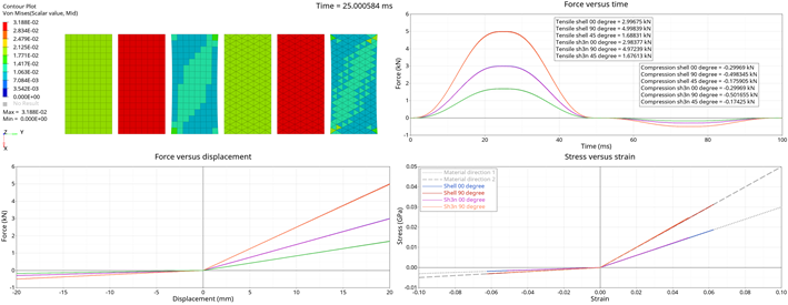

Results with Reference State
During the fabric seaming and/or folding process (airbag, seatbelt, seat cushion, and so on), the initial shape of the fabric component is usually smaller (or bigger) than the reference one, (the one before assembling). This reference shape can be stored in the reference state as /XREF (node based) or /EREF (element based).
From the previous model, the initial size of the sample is reduced by around 10% and the reference shape is stored in an /XREF card.
The imposed displacement is shifted by the distance to recover the reference state (+32mm).
Rayleigh damping is added on all nodes to reduce the effect of the elastic vibration with:
  • Around 0.1% of mass damping: alpha = 0.001 / time step = 0.851
  • Around 1% of stiffness damping: beta = 0.01 * time step
In the results, there is no force (only small force from mass effect, inertia and stability numerical damping) until the displacement reaches 32mm because of the flag ZEROSTRESS=1 in the fabric material.
When the reference state is recovered, the material behavior is exactly the same as the model without a reference state.
Figure 3. Tensile and compression results with initial reference state
The initial compression strain (10%) can be seen in the stress strain curve.
There are elastic vibrations when the reference state is recovered because the material is bilinear without smooth transition between tensile and compression.

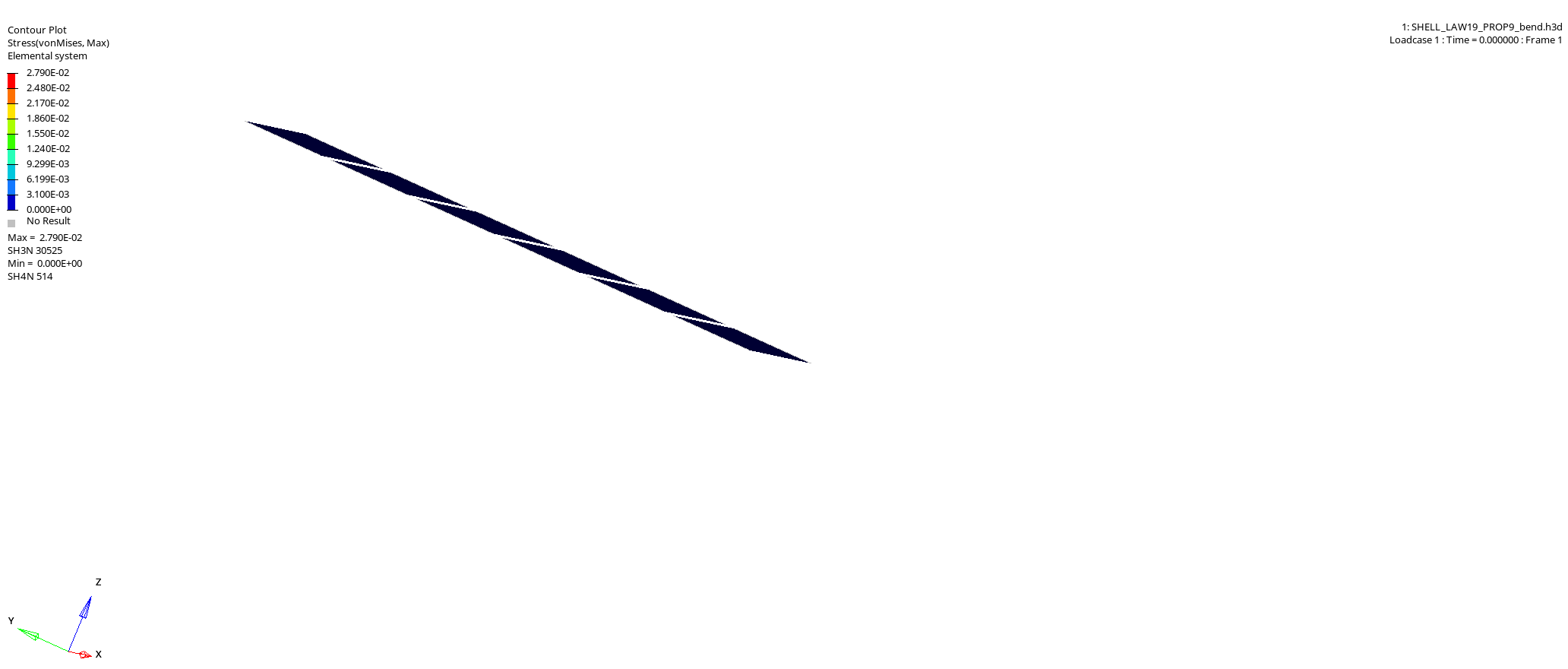

Results Under Gravity Load
The simple fabric material behavior under gravity load is represented below:
Figure 4.
