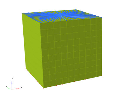

A cube (100mm*100mm*100mm) modeled with solid elements (/PROP/SOLID) and foam material (/MAT/LAW70) is compressed or extended in the vertical direction.
The nodes of the cube top surface are defined in a rigid body (/RBODY) with a vertical imposed displacement defined with a smooth function (/FUNCT_SMOOTH).
The nodes of the cube lower surface are also defined in a rigid body and its main node is clamped using a boundary condition (/BCS).

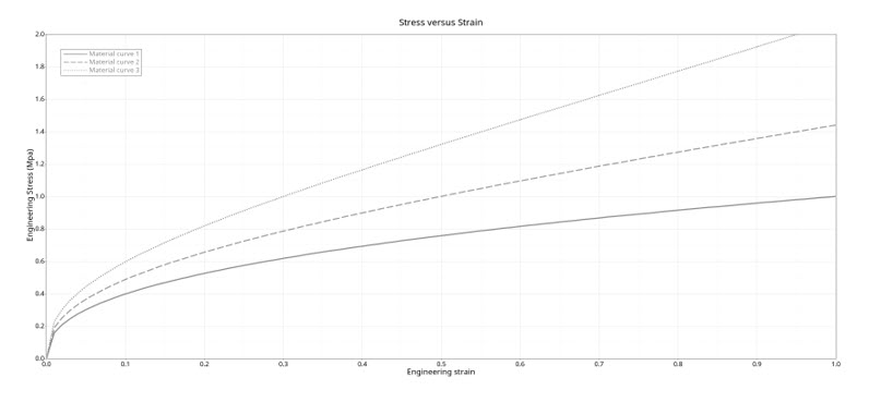

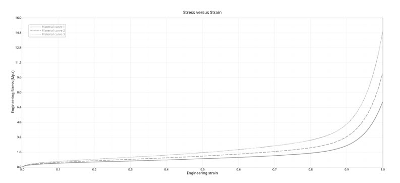

The material is defined with engineering stress versus engineering strain with several curves for the strain rate dependency.

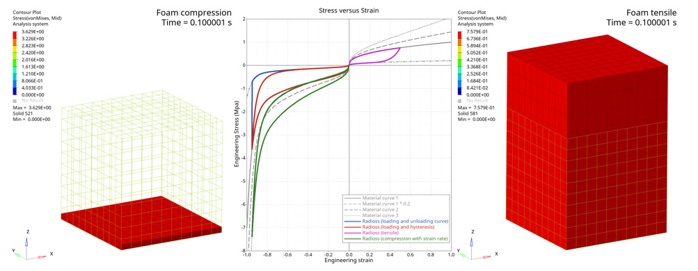

Results
| Stress @ 40% strain during loading phase | Radioss result | Input curve | Difference |
| 0220_foam_LAW70_0 | -0.7588378906250001 | -0.757144898 | 0.2% |
| 0220_foam_LAW70_1 | -0.7588378906250001 | -0.757144898 | 0.2% |
| 0220_foam_LAW70_2 | 0.6936982421875 | 0.693144843 | 0.1% |
| 0220_foam_LAW70_3 | -1.2752874023437502 | -1.271712685 | 0.3% |
| Stress @20% strain during unloading phase | Radioss result | Input curve | Difference |
| 0220_foam_LAW70_0 | -0.10638489990234376 | -0.10506111220000001 | 1.3% |
| 0220_foam_LAW70_1 | -0.10643869628906251 | -0.10506111220000001 (*) | 1.3% |
| 0220_foam_LAW70_2 | 0.10709613037109375 | 0.105061112 (*) | 1.9% |
| 0220_foam_LAW70_3 | -0.49272646484375004 | -0.498375326 (*) | 1.1% |
(*) Estimated value from hysteresis value, static and dynamic curves.
The engineering stress versus engineering stress computed from the rigid body force and nodal displacement give results which overlay exactly the input curve from the material.
The unloading behavior with model with the unloading curve (0220_foam_LAW70_0) is less realistic than the model with hysteresis behavior (0220_foam_LAW70_1).
