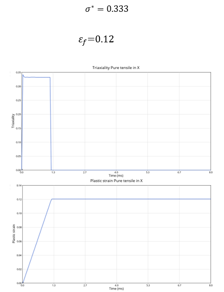

As expected, the elements failed once they reached the plastic strain, then the stress decrease:
ε f = 0.12 MathType@MTEF@5@5@+= feaahGart1ev3aqatCvAUfeBSjuyZL2yd9gzLbvyNv2CaerbuLwBLn hiov2DGi1BTfMBaeXatLxBI9gBaerbd9wDYLwzYbItLDharqqtubsr 4rNCHbGeaGqiVCI8FfYJH8YrFfeuY=Hhbbf9v8qqaqFr0xc9pk0xbb a9q8WqFfeaY=biLkVcLq=JHqpepeea0=as0Fb9pgeaYRXxe9vr0=vr 0=vqpWqaaeaabiGaciaacaqabeaadaqaaqaaaOqaaabaaaaaaaaape GaeqyTdu2damaaBaaaleaapeGaamOzaaWdaeqaaOWdbiabg2da9iaa icdacaGGUaGaaG4maaaa@3C42@
Pure tensile

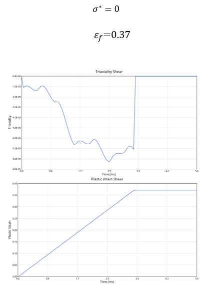

ε f = 0.37 MathType@MTEF@5@5@+= feaahGart1ev3aqatCvAUfeBSjuyZL2yd9gzLbvyNv2CaerbuLwBLn hiov2DGi1BTfMBaeXatLxBI9gBaerbd9wDYLwzYbItLDharqqtubsr 4rNCHbGeaGqiVCI8FfYJH8YrFfeuY=Hhbbf9v8qqaqFr0xc9pk0xbb a9q8WqFfeaY=biLkVcLq=JHqpepeea0=as0Fb9pgeaYRXxe9vr0=vr 0=vqpWqaaeaabiGaciaacaqabeaadaqaaqaaaOqaaabaaaaaaaaape GaeqyTdu2damaaBaaaleaapeGaamOzaaWdaeqaaOWdbiabg2da9iaa icdacaGGUaGaaG4maaaa@3C42@
Pure shear

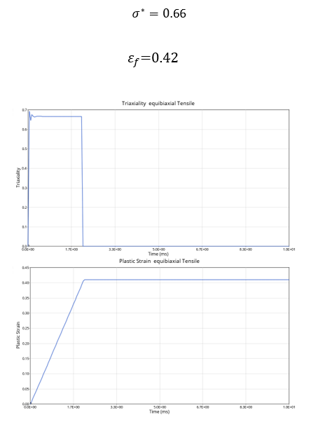

ε f = 0.42 MathType@MTEF@5@5@+= feaahGart1ev3aqatCvAUfeBSjuyZL2yd9gzLbvyNv2CaerbuLwBLn hiov2DGi1BTfMBaeXatLxBI9gBaerbd9wDYLwzYbItLDharqqtubsr 4rNCHbGeaGqiVCI8FfYJH8YrFfeuY=Hhbbf9v8qqaqFr0xc9pk0xbb a9q8WqFfeaY=biLkVcLq=JHqpepeea0=as0Fb9pgeaYRXxe9vr0=vr 0=vqpWqaaeaabiGaciaacaqabeaadaqaaqaaaOqaaabaaaaaaaaape GaeqyTdu2damaaBaaaleaapeGaamOzaaWdaeqaaOWdbiabg2da9iaa icdacaGGUaGaaG4maaaa@3C42@
Biaxial tension

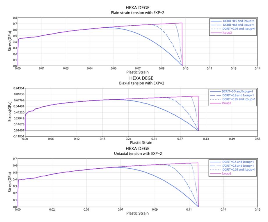

Effect of /FAIL/BIQUAD parameters on damage
The following parameters are tested:
  • ICOUP=1 with S-Flag=2
    • DCRIT=0.5
    • DCRIT=0.8
    • DCRIT=0.95
  • ICOUP=2 with S-Flag=3
    Figure 1. Effect of DCRIT parameter on stress softening triggering
With ICOUP=1, the critical damage parameter DCRIT is tested with different values. The more the value of DCRIT is increased, the later the softening is applied on the stress. The exponent parameter EXP is used to control the shape of the stress softening so that it is nonlinear when EXP is different from 1.
With ICOUP=2, no influence on softening can be observed when using Solid Hexaedron degenerated elements.
