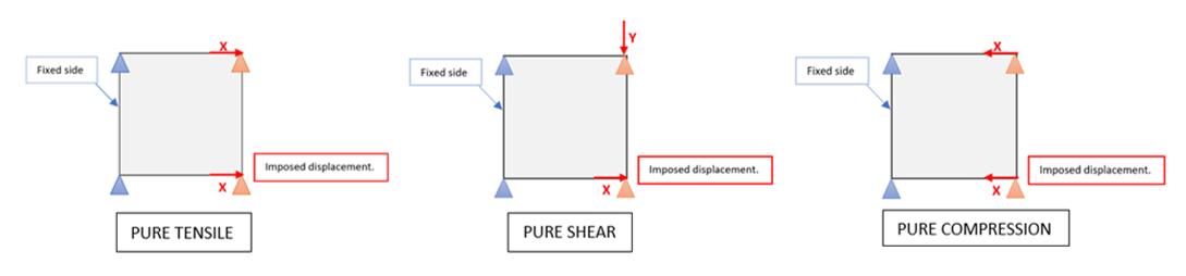

The boundary conditions are represented.
Figure 2. All boundary conditions applied to the model

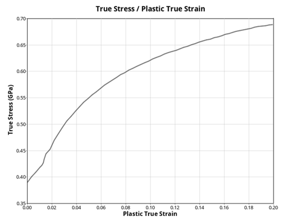

  • LAW36
    The elasto-plastic behavior is defined using the tabulated material LAW36. The True Stress versus Plastic True Strain curve is used as an input of LAW36. For more information about the LAW36 material, refer to RD-V: 0240 Tabulated Material (LAW36) in Verification Problems.
    Figure 3. True stress versus True strain

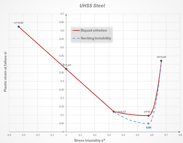

  • /FAIL/BIQUAD
    This failure model uses a simplified nonlinear failure criterion based on plastic strain with linear damage accumulation. The failure strain is described by two parabolic functions, which are calculated by curve fitting from up to 5 failure strains entered by you represented below:
    c1
    Failure strain at uniaxial compression test
    where σ * = − 1 / 3 MathType@MTEF@5@5@+= feaahGart1ev3aaatCvAUfeBSjuyZL2yd9gzLbvyNv2CaerbuLwBLn hiov2DGi1BTfMBaeXatLxBI9gBaerbd9wDYLwzYbItLDharqqtubsr 4rNCHbGeaGqiVu0Je9sqqrpepC0xbbL8F4rqqrFfpeea0xe9Lq=Jc9 vqaqpepm0xbba9pwe9Q8fs0=yqaqpepae9pg0FirpepeKkFr0xfr=x fr=xb9adbaqaaeGaciGaaiaabeqaamaabaabaaGcbaGaeq4WdmNaai Okaiabg2da9iabgkHiTiaaigdacaGGVaGaaG4maaaa@3C86@
    c2
    Failure strain at pure shear test
    where σ * = 0 MathType@MTEF@5@5@+= feaahGart1ev3aaatCvAUfeBSjuyZL2yd9gzLbvyNv2CaerbuLwBLn hiov2DGi1BTfMBaeXatLxBI9gBaerbd9wDYLwzYbItLDharqqtubsr 4rNCHbGeaGqiVu0Je9sqqrpepC0xbbL8F4rqqrFfpeea0xe9Lq=Jc9 vqaqpepm0xbba9pwe9Q8fs0=yqaqpepae9pg0FirpepeKkFr0xfr=x fr=xb9adbaqaaeGaciGaaiaabeqaamaabaabaaGcbaGaeq4WdmNaai Okaiabg2da9iabgkHiTiaaigdacaGGVaGaaG4maaaa@3C86@
    c3
    Failure strain at uniaxial tension test
    where σ * = 1 / 3 MathType@MTEF@5@5@+= feaahGart1ev3aaatCvAUfeBSjuyZL2yd9gzLbvyNv2CaerbuLwBLn hiov2DGi1BTfMBaeXatLxBI9gBaerbd9wDYLwzYbItLDharqqtubsr 4rNCHbGeaGqiVu0Je9sqqrpepC0xbbL8F4rqqrFfpeea0xe9Lq=Jc9 vqaqpepm0xbba9pwe9Q8fs0=yqaqpepae9pg0FirpepeKkFr0xfr=x fr=xb9adbaqaaeGaciGaaiaabeqaamaabaabaaGcbaGaeq4WdmNaai Okaiabg2da9iabgkHiTiaaigdacaGGVaGaaG4maaaa@3C86@
    c4
    Failure strain at plain strain tension test
    where σ∗=1/√3
    c5
    Failure strain at biaxial tension test
    where σ * = 2 / 3 MathType@MTEF@5@5@+= feaahGart1ev3aaatCvAUfeBSjuyZL2yd9gzLbvyNv2CaerbuLwBLn hiov2DGi1BTfMBaeXatLxBI9gBaerbd9wDYLwzYbItLDharqqtubsr 4rNCHbGeaGqiVu0Je9sqqrpepC0xbbL8F4rqqrFfpeea0xe9Lq=Jc9 vqaqpepm0xbba9pwe9Q8fs0=yqaqpepae9pg0FirpepeKkFr0xfr=x fr=xb9adbaqaaeGaciGaaiaabeqaamaabaabaaGcbaGaeq4WdmNaai Okaiabg2da9iabgkHiTiaaigdacaGGVaGaaG4maaaa@3C86@
    The failure model used in this study is UHSS Steel, corresponding to Mflag=3.
    Figure 4. ε f − σ * MathType@MTEF@5@5@+= feaahGart1ev3aaatCvAUfeBSjuyZL2yd9gzLbvyNv2CaerbuLwBLn hiov2DGi1BTfMBaeXatLxBI9gBaerbd9wDYLwzYbItLDharqqtubsr 4rNCHbGeaGqiVu0Je9sqqrpepC0xbbL8F4rqqrFfpeea0xe9Lq=Jc9 vqaqpepm0xbba9pwe9Q8fs0=yqaqpepae9pg0FirpepeKkFr0xfr=x fr=xb9adbaqaaeGaciGaaiaabeqaamaabaabaaGcbaGaeqyTdu2aaS baaSqaaiaadAgaaeqaaOGaeyOeI0Iaeq4Wdm3aaWbaaSqabeaacaGG Qaaaaaaa@3C4A@ curve in /FAIL/BIQUAD
