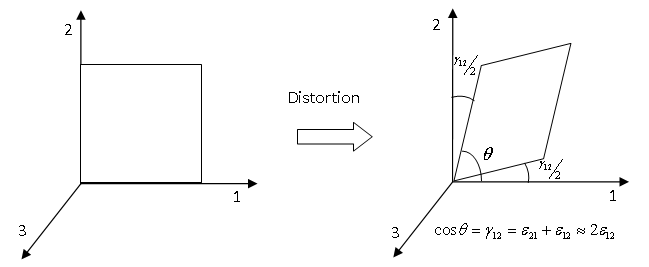

    γ 12 = 1 2 G 12 σ 12 ν 21 E 22 = ν 12 E 11 γ 23 = 1 2 G 23 σ 23 ν 32 E 33 = ν 23 E 22 γ 31 = 1 2 G 31 σ 31 ν 13 E 11 = ν 31 E 33
    Where,
    ε i j
    Strains
    σ i j
    Stresses
    γ 12 , γ 23 and γ 31
    Distortions in the corresponding material directions
    For example, for γ 12 :
    mat_law12_distortion
