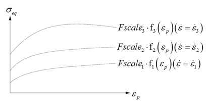

  10. If ε ˙ n ε ˙ ε ˙ n + 1 , yield stress is a cubic interpolation between functions fn-1, fn, fn+1 and fn+2.
  11. If ε ˙ ε ˙ 1 , yield stress is extrapolated between functions f 1 MathType@MTEF@5@5@+= feaagKart1ev2aaatCvAUfeBSjuyZL2yd9gzLbvyNv2CaerbuLwBLn hiov2DGi1BTfMBaeXatLxBI9gBaerbd9wDYLwzYbItLDharqqtubsr 4rNCHbGeaGqiVu0Je9sqqrpepC0xbbL8F4rqqrFfpeea0xe9Lq=Jc9 vqaqpepm0xbba9pwe9Q8fs0=yqaqpepae9pg0FirpepeKkFr0xfr=x fr=xb9adbaqaaeGaciGaaiaabeqaamaabaabaaGcbaGaciOzamaaBa aaleaacaaIXaaabeaaaaa@37C9@ , f 2 MathType@MTEF@5@5@+= feaagKart1ev2aaatCvAUfeBSjuyZL2yd9gzLbvyNv2CaerbuLwBLn hiov2DGi1BTfMBaeXatLxBI9gBaerbd9wDYLwzYbItLDharqqtubsr 4rNCHbGeaGqiVu0Je9sqqrpepC0xbbL8F4rqqrFfpeea0xe9Lq=Jc9 vqaqpepm0xbba9pwe9Q8fs0=yqaqpepae9pg0FirpepeKkFr0xfr=x fr=xb9adbaqaaeGaciGaaiaabeqaamaabaabaaGcbaGaciOzamaaBa aaleaacaaIXaaabeaaaaa@37C9@ and f 3 MathType@MTEF@5@5@+= feaagKart1ev2aaatCvAUfeBSjuyZL2yd9gzLbvyNv2CaerbuLwBLn hiov2DGi1BTfMBaeXatLxBI9gBaerbd9wDYLwzYbItLDharqqtubsr 4rNCHbGeaGqiVu0Je9sqqrpepC0xbbL8F4rqqrFfpeea0xe9Lq=Jc9 vqaqpepm0xbba9pwe9Q8fs0=yqaqpepae9pg0FirpepeKkFr0xfr=x fr=xb9adbaqaaeGaciGaaiaabeqaamaabaabaaGcbaGaciOzamaaBa aaleaacaaIXaaabeaaaaa@37C9@ .
  12. If ε ˙ Nfunc 1 ε ˙ ε ˙ Nfunc , yield is interpolated between functions fNfunc-3, fNfunc-2, fNfunc-1 and fNfunc.
  13. If ε ˙ > ε ˙ Nfunc , yield is extrapolated between functions fNfunc-2, fNfunc-1 and fNfunc.
    mat_law60_yield
  14. Functions describing strain dependence must be defined for different strain rates values.
  15. Strain rate values must be given in strictly ascending order.
