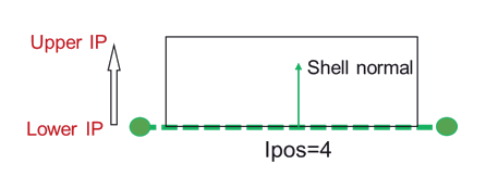

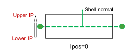

Ipos Mid shell positioning flag. 12
= 0 (Default)
No shell offset.
= 3
The upper surface is coincident with the element mid-surface.
= 4
The lower surface is coincident with the element mid-surface.
(Integer)

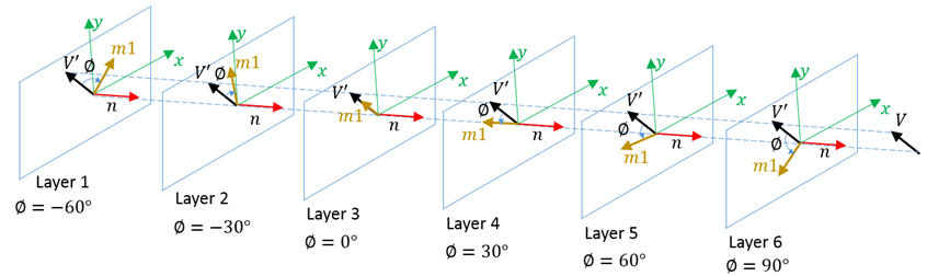

Example
Figure 1. 6 Layers with Different Material Direction (Fiber Direction)
prop_type10_example
#RADIOSS STARTER
#-  1. LOCAL_UNIT_SYSTEm:
/UNIT/2
unit for prop
#              MUNIT               LUNIT               TUNIT
                  kg                  mm                  ms
#-  2. GEOMETRICAL SETS:
/PROP/SH_COMP/2/2
SH_COMP example
#   Ishell    Ismstr     Ish3n    Idrill                             Pthick_fail
        12         0         0         0                                       0
#                 hm                  hf                  hr                  dm                  dn
                   0                   0                   0                  .1                  .1
#        N                         Thick              Ashear              Ithick     Iplas
         6                           1.8                   0                   1         1
#                 Vx                  Vy                  Vz   skew_ID                Ipos        Ip
                   1                   0                   1         0                   0         0
#              Phi_1               Phi_2               Phi_3               Phi_4               Phi_5
                 -60                 -30                   0                  30                  60
                  90
#enddata

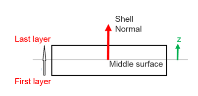

  9. The material direction definition in the initial state card (/INISHE/ORTHO, /INISH3/ORTHO) overwrites the material direction.
    In the case of reference metrics, the orientation for directions of anisotropy must be defined with the reference geometry, not the initial one.
    The 2nd material direction m2 is derived from direction m1 rotated 90 degrees (orthotropic).
    Layers are overlaying one by one from bottom to top.
    Figure 4.

  12. Ipos: Shell position or thickness offset:
    • Ipos=0: No shell offset
    • Ipos=3: The upper surface is coincident with the element mid-surface.
    • Ipos=4: The lower surface is coincident with the element mid-surface.
