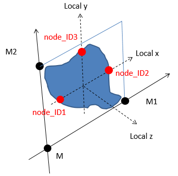

  1. The elements groups defined will be intersected by the defined parallelogram. The lines M–M1 and M–M2 (Figure 1) define the parallelogram. The section nodes are created from the nodes of those intersected elements, which are on the upside (z > 0) of the plane of the parallelogram.

  3. The local force and moment output system of the section is defined using 3 nodes. These three nodes should be nodes on the section plane, so their position is updated when the section moves. When using the Cross-Section Assistant in HyperMesh to create the section, the 3 nodes are automatically selected.
    Local system is defined as:
    • Nodes node_ID1 and node_ID2 define the local x-axis of the section.
    • Nodes node_ID1, node_ID2, and node_ID3 define the local plane xy of the section.
    • The local y-axis is defined by projecting node_ID3 perpendicular to the local x-axis.
    • The intersection of the local x- and y-axis is then the origin of the system.
    • Last, the section normal is the local z-axis which is perpendicular to the xy plane.
    • The center of the section can be redefined using the Iframe option. Refer to Force and Moment Computation in the User Guide for further details.
